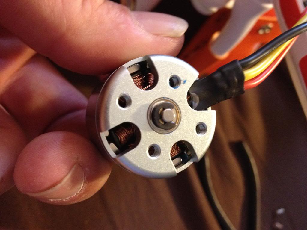

    I may have found the culprit..at least here's hoping. After a quick flight a couple of hours ago..and still acting erratic. I came in, ran it through the software, and then let it idle (no props) to run the battery down, and I noticed one motor sounded funny, so this one motor was warm to the touch. Ok figured I need a new motor. So I took the top off and there was a little c clamp? (cant think of what the real name is ) that came loose and was stuck perfectly between the top and bottom of the motor, just enough to cause the motor to not run freely. So I put that back where it belonged, (holding the motor shaft in place). So I am guessing the next time I fly it will act normal.

    You talking this

    Seems like a slam dunk.
    You have observed the effect (heat) and found the cause (loose c-ring).

    Yes ..Exactly..I flew it yesterday and it seems back to normal...thanks
