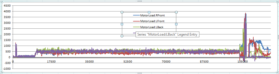

I couldn't get Dashwear to work so I graphed it in Excel the motor speed Vs Motor Load.....This is from when the problem started right around 102500 ms.... from 0 to 102500 was all OK I will post one that has all the time series......

Nice charts!
As you see there is no load on motor right back at the read square - that means prop flew off at the time where the arrow head is. Also RPM increases to 10000. Thats the RPM at which the motor runs when you have no prop on and apply full throttle(P3 applies full throttle automatically as you would see from the Motor CMD column if you plot it).
After the red square you will note load increases. Thats the impact time into ground and motors are obstructed by the soil. Happens at around 6300ms. All motors load spike at right about that time.
You should plot GPS altitude to verify the time at which the P3 hits the ground (or the accelZ(M/S2) column)
You will also note that after impact there is is no load on motor right back again showing there is no prop on this motor.
