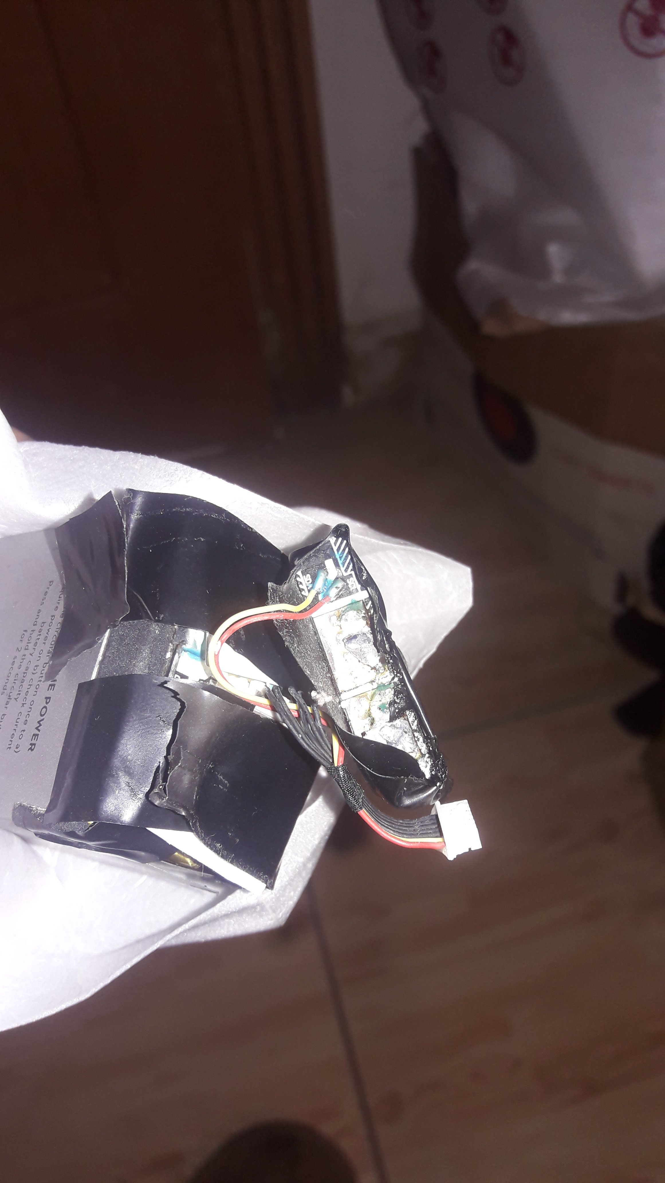

i didnt have time to make a video so ill share some pics of the p3 and its modded battery
i found that on the battery the 2 lines are marked sda scl

this is the pic of a p3 dissembled smart battery plug where the sda, scl written on connectors, where the red and yellow wires connect, all p3 batteries i saw earlier are marked like that
