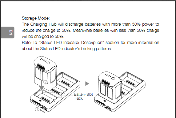

  3. rhrpilot
    Jul 4, 2014
    18
    Florida
    Thanks for your reply; however, the instructions definitely state that the charging hub in the storage mode will discharge batteries to the 50% level.
  4. msinger
    Approved Vendor
    Oct 30, 2014
    27,791
    8,638
    Harrisburg, PA (US)
    You're right. It's odd that they did not include that as a feature in their store.
