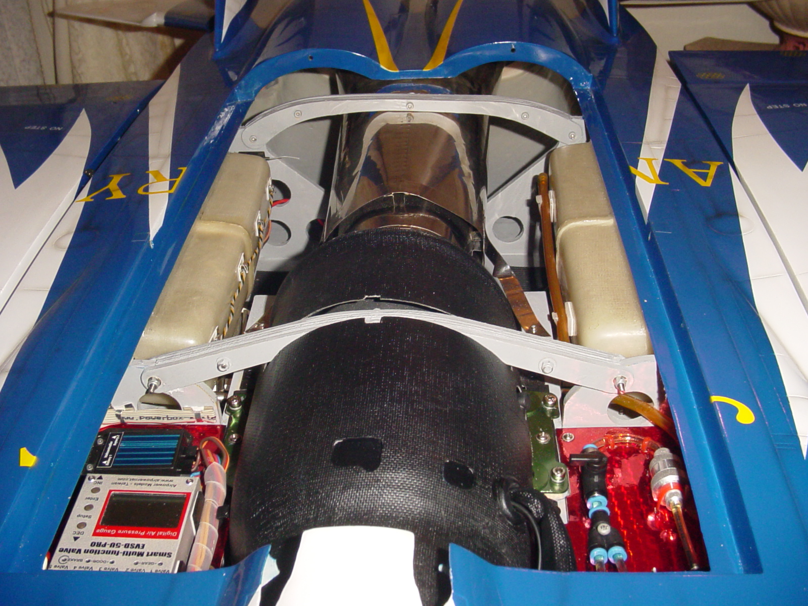

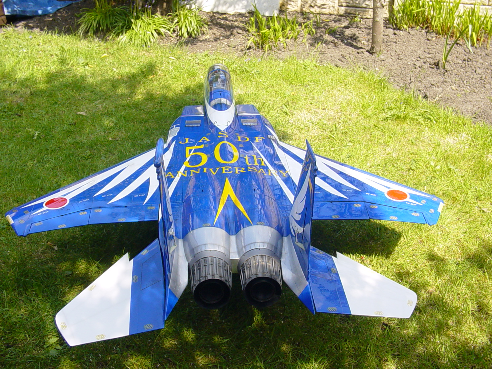

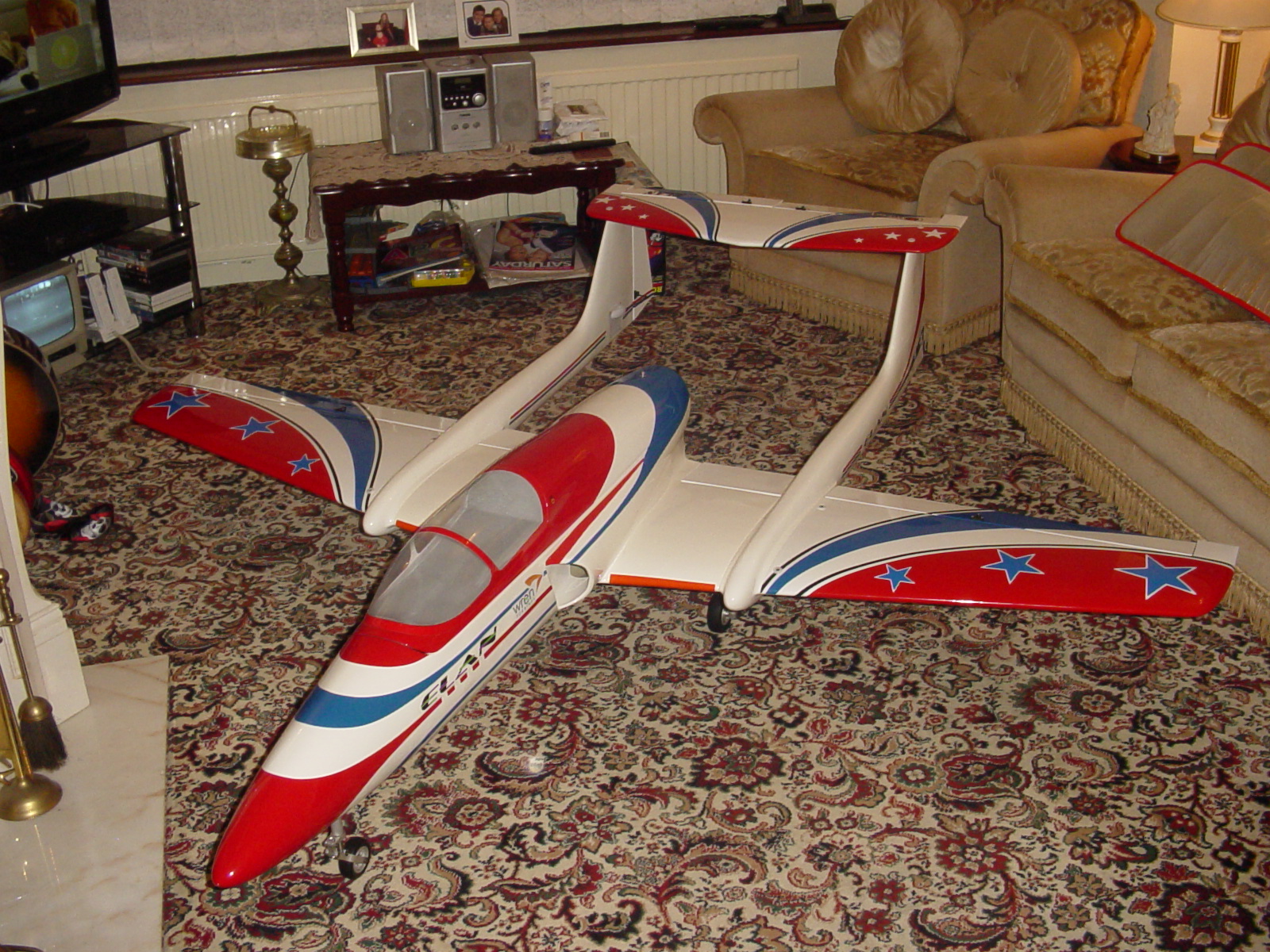

the other thing i wonder about is, does the cycle amount determine the life span of the battery
or the amount of use after each flight ie the amount taken from the battery in Milliamp hours
never had to do this on the good old lipo's on my fixed wing aircraft and they last for years if looked after
even the 2 cell lipo's for the turbine engine start up motors last a good time
in my turbine jets
regards Ian
