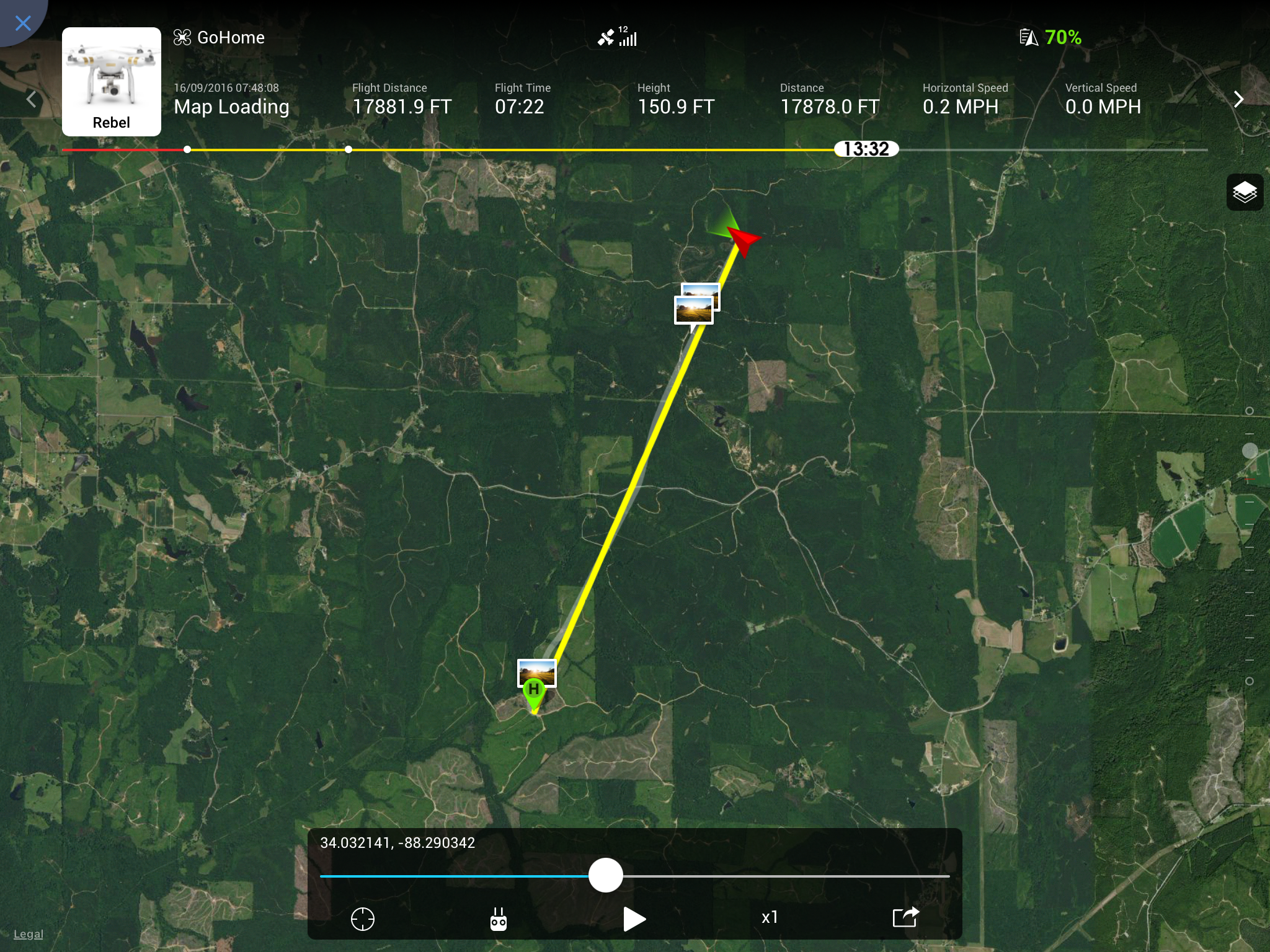

    In the right place with no noise I just did this .
    3.39 miles.PNG The antenna on your TX is 5.8 and you have 2 2.4 antenna panels inside the TX .
    Added / That's not a p3 4k tx but that panel does work with one

    Yep, they DO work great. @dirkclod, did you really do this distance flight at 150' feet? I gotta be way up there at 400' (or better) to get out that far.

    Oh yea
