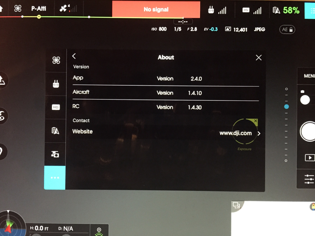

    Guys, this is becoming widespread. Myself, along with numerous others are experiencing the red "no signal" after upgrading to 1.4. This all started around early October and so far we don't have a fix. At first I thought it could be iOS 9, but it doesn't appear to be isolated to apple products. It's possible that something in the latest two versions of the DJI GO app is causing the problem. I read that they've included support for lightbridge 2, so possibly the broke part of lightbridge 1 in doing so. I don't know the answer but together we may be able to figure this out before DJI does. Knowing them, Christmas will come first.

    This is the wrong thread. This is not for the "NO SIGNAL" error, which means the controller can't connect to the aircraft. This is a thread for the "DISCONNECTED" error, which is entirely different and has nothing to do with the aircraft.

    RangerOne, this is a thread you started regarding DJI GO and connection problems with the controller, right? The problems are related, admit it or not, the issue appears to be with 1.4. Everything was working fine for us all on 1.3.2.

    Myself and others are experiencing the same issues you are. The only difference is that you are able to establish a connection, then you lose it. So far I can't establish a connection (live video feed), but the controls and the bird work fine and fly fine. I will bet this is related to 1.4 and the addition of lightbridge 2 support being added for the latest 2 versions of DJI GO. That's when the problems started for all of us, not just you.

    Sorry, I was referring to your screen shot and the text that referenced a red "no signal" indication. I have never experienced this signal short of my aircraft being off. I believe my aircraft its still transmitting video and telemetry, and suspect that my controller is receiving it just fine. The app just disconnects from the controller and can't reconnect until I power cycle the controller. When this happens I can't even get into DJI Go -- no camera video, no aircraft connection, nothing.
    Some of the symptoms may be similar (lack of video, etc) but it seems to me like they are unrelated. If there were a driver issue on the aircraft or a compatibility issue with Lightbridge 1/2 handling either in the aircraft or in the controller, one would expect it to be consistent (as yours is, so these do seem like possible causes for your issue). But mine works fine for periods of time, and I don't get the red "no signal" error.
    My post is strictly about the "disconnected" phenomenon.
