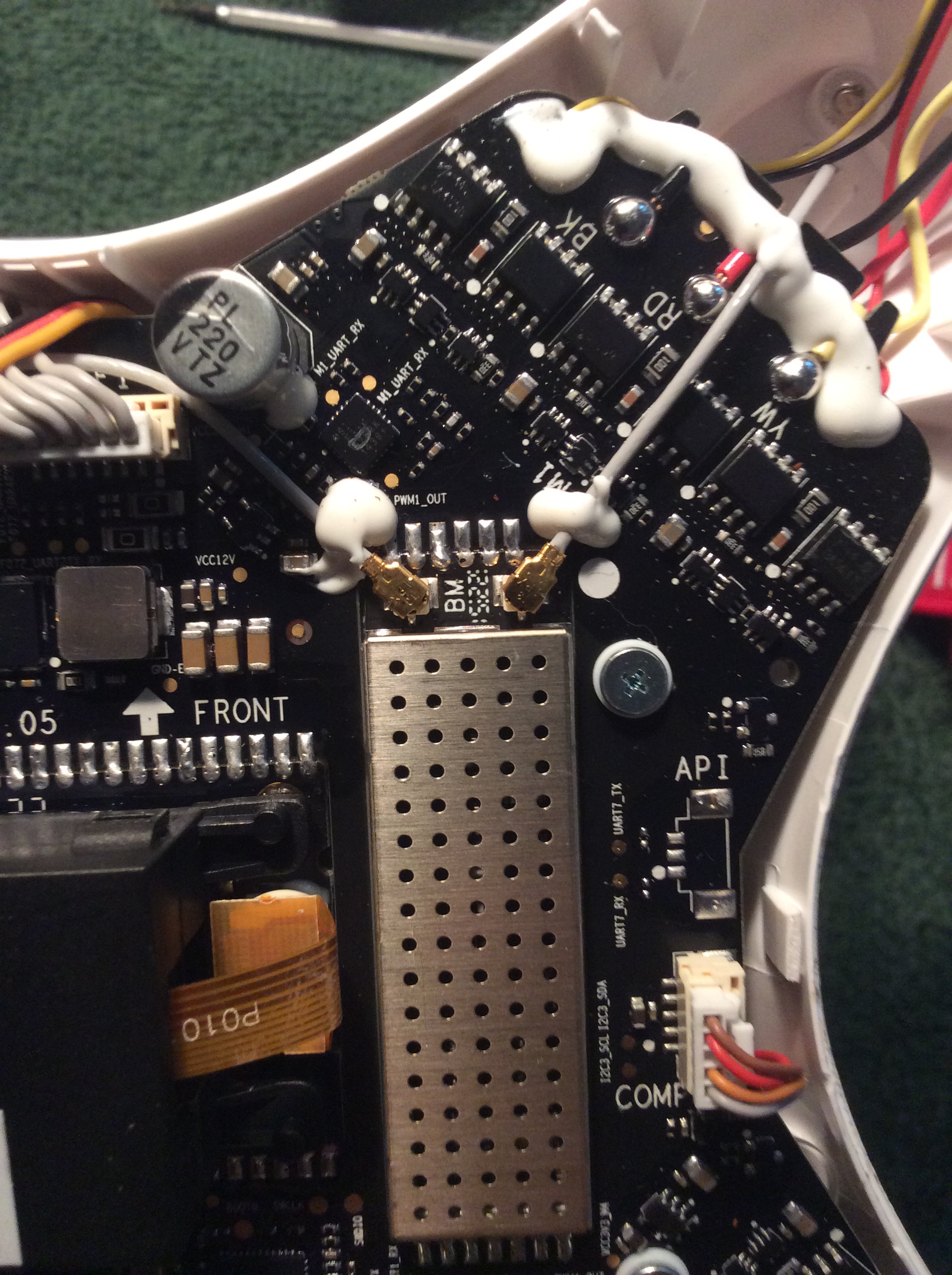

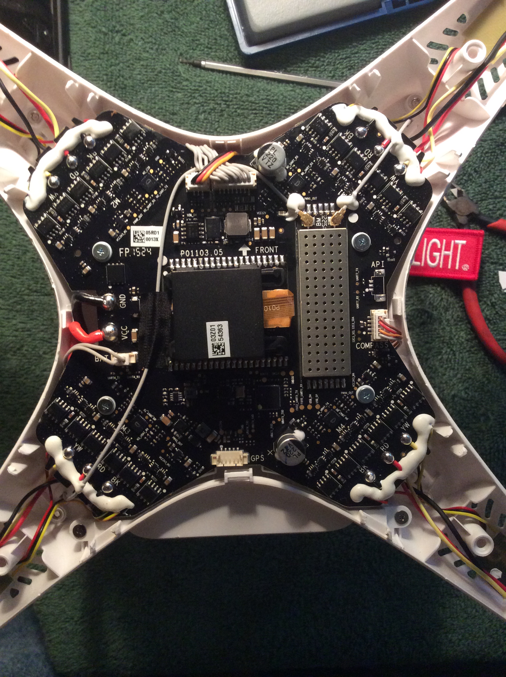

    [​IMG]

    I see nothing there Youngblood .What does puzzles me is why mine looks like this .With the silicone ,strange
