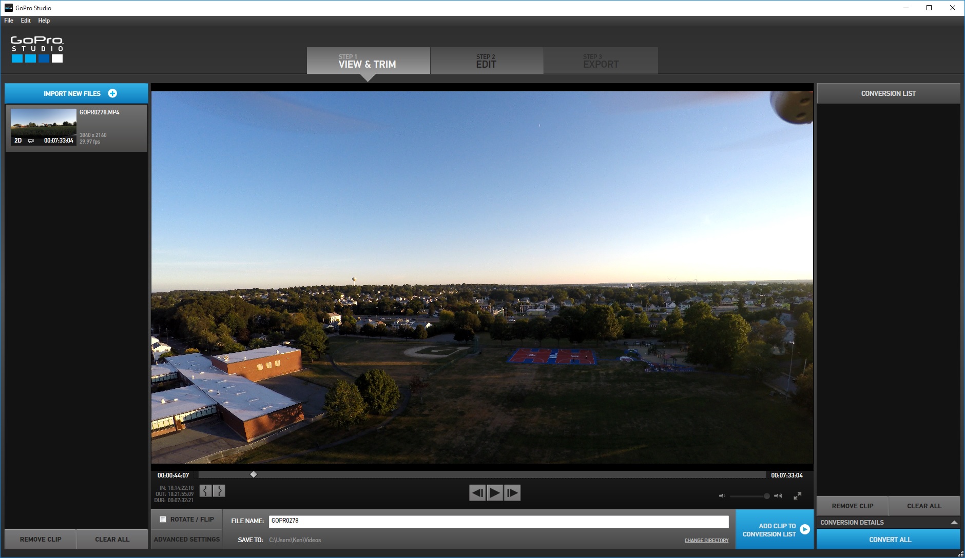

    Here is a shot of mine, and my trim buttons are active. But for the life of me I can't seem to find where I can get the version number of Studio! There's no Help-->About in the silly thing... Where the heck is it???

    The video you have is from a Gopro device. It says GOPRO278.MP4 file. What I am referring to is NON-Gopro video like from the P3/P2 Visions.
    On a side note, to find your version, go in control panel > programs and features. The right column should contain the version info.
