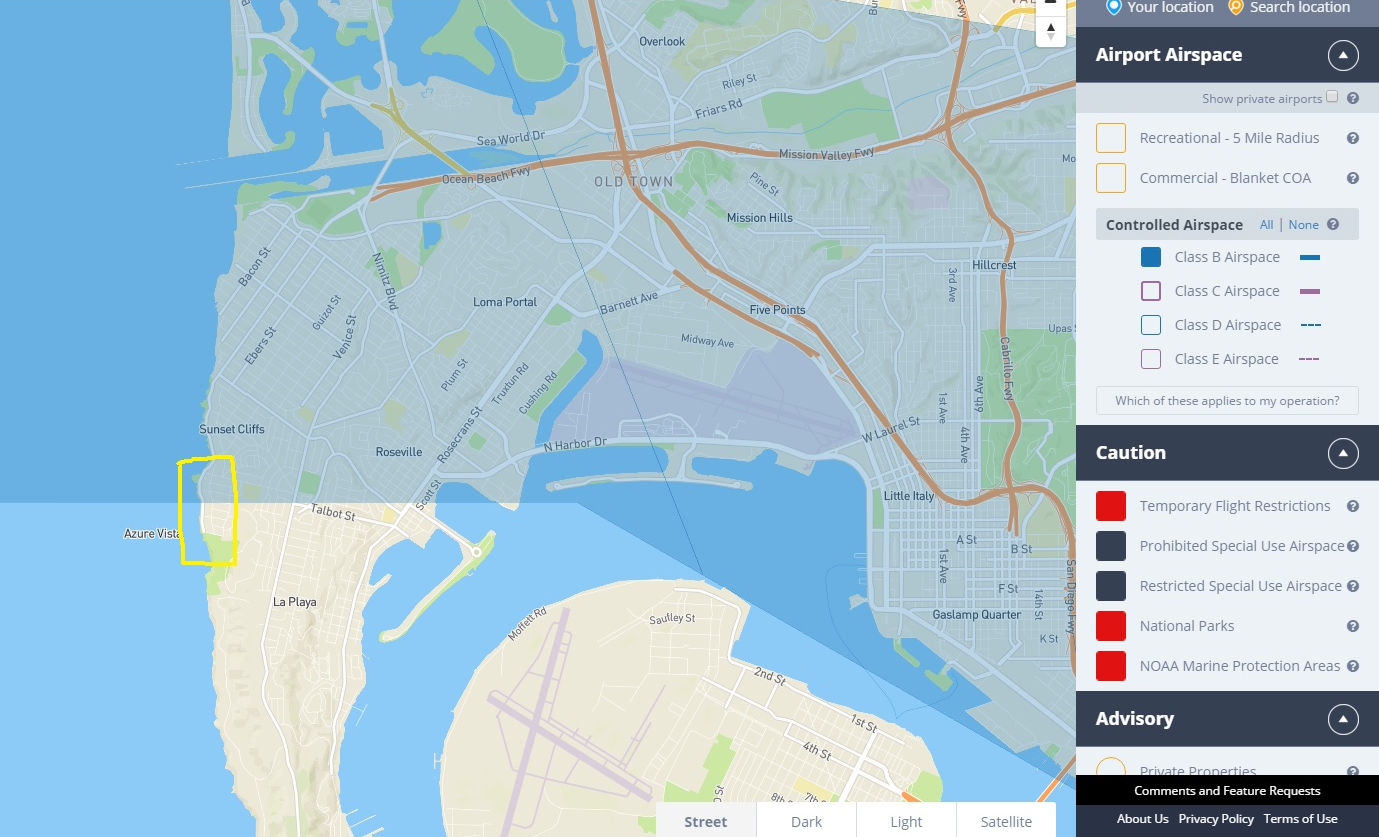

    Good Point Air Ontario!... the upside down cake! Forgot about that for a moment, was fixated on the 5 mile radius. Pt Loma Nazarene area, off Sunset Cliffs Blvd/ Ladera St. The area in yellow was my target area, half in and half out of classB. What's the best way to figure out whether I'll be in that layer cake at that location? The tower said, "I know exactly where that is and you are definitely in Class B at that location" but now I'm not so sure. Looks like 3 miles to end of runway.

    Check the sectional. If it's class B to the SFC, it's no go.

    I was intending where the green line is. I'm not familiar with how to read these yet but I'm thinkin it says SFC for SAN but not Halsey? So if I keep further down the point I should be fine?

    Let me help you read this chart. The area in green, the top half is in Class B airspace from surface to 10,000 feet. Not sure what the FAA says about UAV operations (which is why I tried getting clarification) in Class B airspace, but as a student pilot I know I cannot go into this airspace without a Mode C transponder, two way radio communications and an endorsement from my CFI. The bottom half of the green line is also in Class B airspace from 2800 feet to 10,000 feet. However, it is also within Class D airspace which generally extends from surface all the way to 2500 feet. The "-28" basically means that the Class D airspace extends from surface up to but not including 2800 feet, at 2800 feet Class B airspace takes over to 10,000 feet.
    There is a VFR corridor where the magenta arrows run along the dashed magenta line to the right of KSAN going from 3300 feet to 4700 feet, but our drones are not allowed there unfortunately. :-(
    The big numbers in the center of each quadrant, the one for your quadrant "0 and then 8 slightly raised above" is the maximum elevation figure which means that the highest point in that quadrant is 800 feet or slightly below. The calculation is the highest elevation plus 100 feet and then adding the height of the highest point or 200 feet, whichever is greatest and rounding off to the next hundred.
    My home is within Class D airspace and I generally have to notify the airport security and tower per my airport's instruction if I want to fly there.

    Basically any box containing blue letters "SFC" on the bottom means class B to the ground. So, south of that box, you're OK as long as you get the verbal from the tower. The easiest way to tell them what you want to do is this:
    Identify your location of operation by providing the heading and distance measured from the center of the airport. Google Earth is good for this. Tell them your max altitude in AGL (I would suggest staying under 200ft) and operating radius (e.g. 1/8 mile) and tell them your start and end time (keep it as narrow as possible).
    P.S. That's the sectional for the airfield where I learned to fly, KMYF.

    For your box, the north end is in San Diego KSAN Class B (100/SFC) and the south end is in North Island Naval Air Station's KNZY Class D. Because of KNZY proximity to KSAN it is a pie wedge extending from the airport to the south. KNZY Class D [-28] goes from the surface to but not including 2,800 feet, at which point KSAN Class B takes over to 10,000 feet (100/28). You are also on the approach end of KNZY runway 11.
