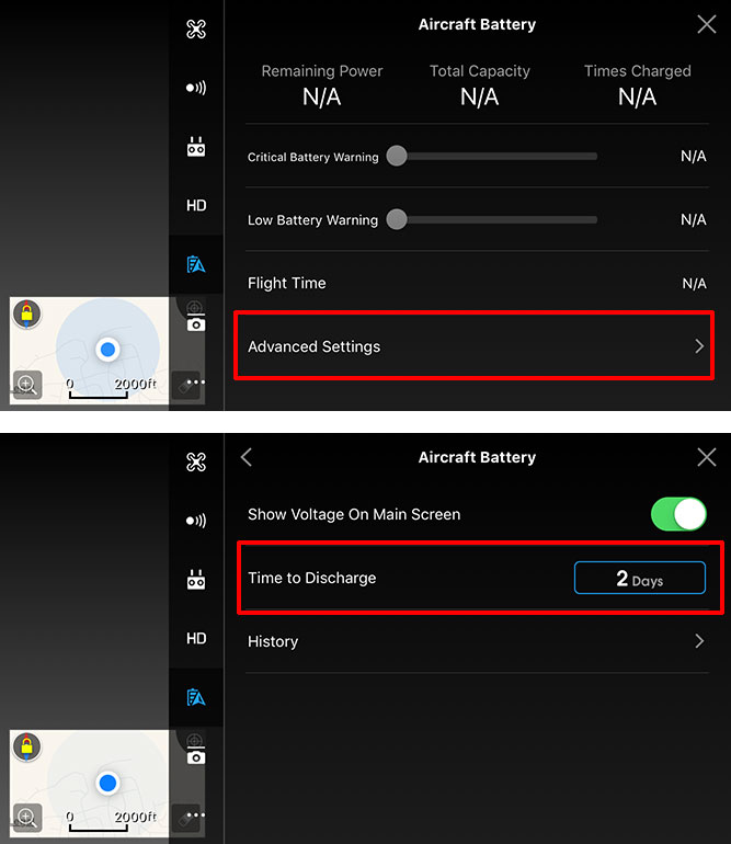

You can always do it sooner, but if you have your discharge settings to say 3 days you would obviously want to make sure your flight takes place prior to the discharge process starting.Thanks - I normally wait until I check the weather conditions and am ready to fly but I wanted to see if I could do it sooner.
By default, they will start to auto discharge down to the storage level on their own after 10 days. You can decrease that time frame by changing the "Time to Discharge" setting in DJI GO. You'll need to change that setting while each battery is installed in your Phantom since the setting is stored on the battery.I thought that batteries should not be kept at full charge for that long?
