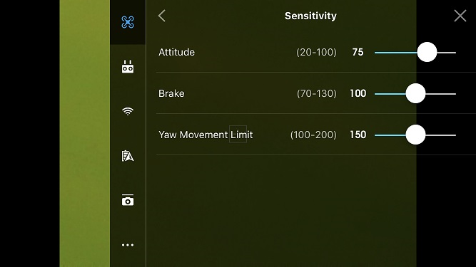

Just one question, when you cancel a lineal command on the joystick, the a/c 'bucks' (leading edge rises rapidly) before settling down. Normal??
Yes, that's perfectly normal. You can either go easier on the sticks to smooth out the movements or adjust the gains/EXP settings in DJI GO to smooth out those movements for you. See more details here.

You can dial down the aggressiveness of the brake and other automated responses. I run my brake at 75% takes a little longer to stop but it's a whole lot smoother. And has to be kinder to the airframe as well.

How do you adjust the 'brake aggression'?
You can adjust the brake in the "Main Controller Settings" --> "Advanced Settings" --> "Sensitivity" section of DJI GO.

OK. Have gone into the 'Sensitivity' setting, the reading was (0-0) 100.
Touched it to highlight it and managed somehow to change the values to (0-0) 0. Can't change it back, even though it highlighted. Doesn't respond to touch?
You need to connect your Phantom to DJI GO before you modify that setting.
Cheers. I had connected but obviously not in the right order. Touchy little rascals.
Now just entered the 'Sensors ' setting and they won't allow adjustment??
You should have bars that slide as shown below. If you do not see those, then try restarting DJI GO.
Hi. Have adjusted the brake thanks, but as said above I have entered 'Sensors' mode but they will not adjust.
I watched a tutorial and it showed 'curves' to adjust sensitivity, may have been a different model. I'm trying to slow the yaw for slower panning.
I guess you're referring to the EXP settings? Nothing can be modified in the "Sensors" section.
