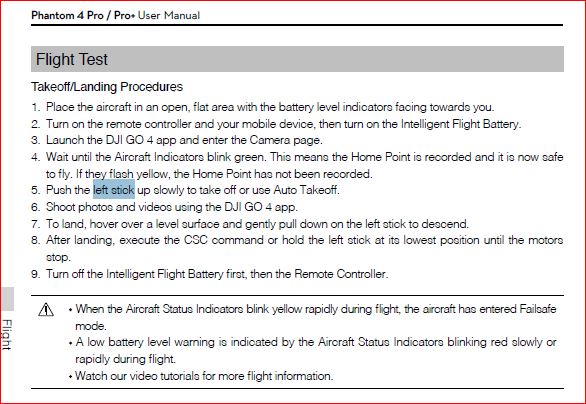

Hello, thank you everyone for your replies. The left stick up to start motors and take-off has always functioned until the problems began. Maybe it was a bug. (But I liked that one). That function was the first thing I noticed to be disabled. Yesterday I tried a stick calibration. Must have gone thru the procedure 10 times or so. No indication of completion on the screen, so I couldn't tell what was going on. The system would always return to start page of calibration?? Also tried camera calibration (locked up at 50% complete) Rebooted controller. Enclosed insert from manual in regards to left stick start-up.. MUI calibration some time today..
Thank You

It looks like there is a step missing from the section of the manual you showed.
It needs to have a line after Step 4 that says Start the motors using the combination stick command (CSC).
Just pushing the left stick will never start the motors.
Go back to the manual and note the section immediately above the section you showed above.
Here's what it says:
