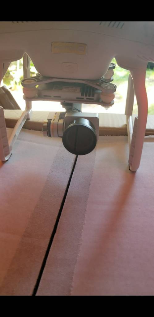

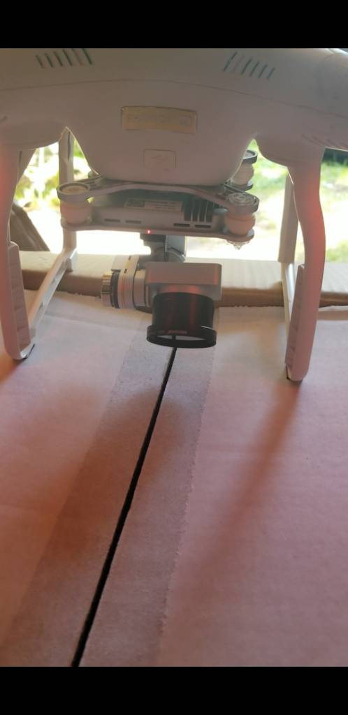

PicturesCamera got wet. I dried it out for 2 days and now it seems ok except every so often it drops like it loses power and then immediately comes back into position. Trying to post a video
I can only see gimble light in boot pic which is red,it top picture with power on to,take off that lens to ditch a bit of weight till you figure it out,is ,does gimble calibration work ,,I take it has no ad card in or has it does gimble light flash or solid...ok how it get wet fresh water or sea water,you might need to unplug ribbons and use tissue to get any water still in join,where the male and female come to join
