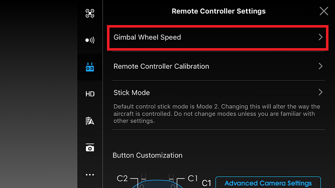

    Hi,
    We got this drone for work an filming for various companies. But i can only find options to film straight "forward" or straight down into the ground.
    Can anyone point me in the direction i need to for instance set the gimal in a 45 degree angle downwards? :)

    You can use the wheel on the top, left of the remote controller to tilt the camera at different angles.

    Tried that but turning the top left wheel does nothing as far as i can see. What should the settings on gimbal and such be in app? I might have done something wrong during setup..

    Try increasing the gimbal wheel speed in DJI GO. Perhaps it's set so low that you cannot see it moving.

    I had aparently set gimbal movement to 0 in advanced :/ stupid me... now it works :)
    Thanks :)
