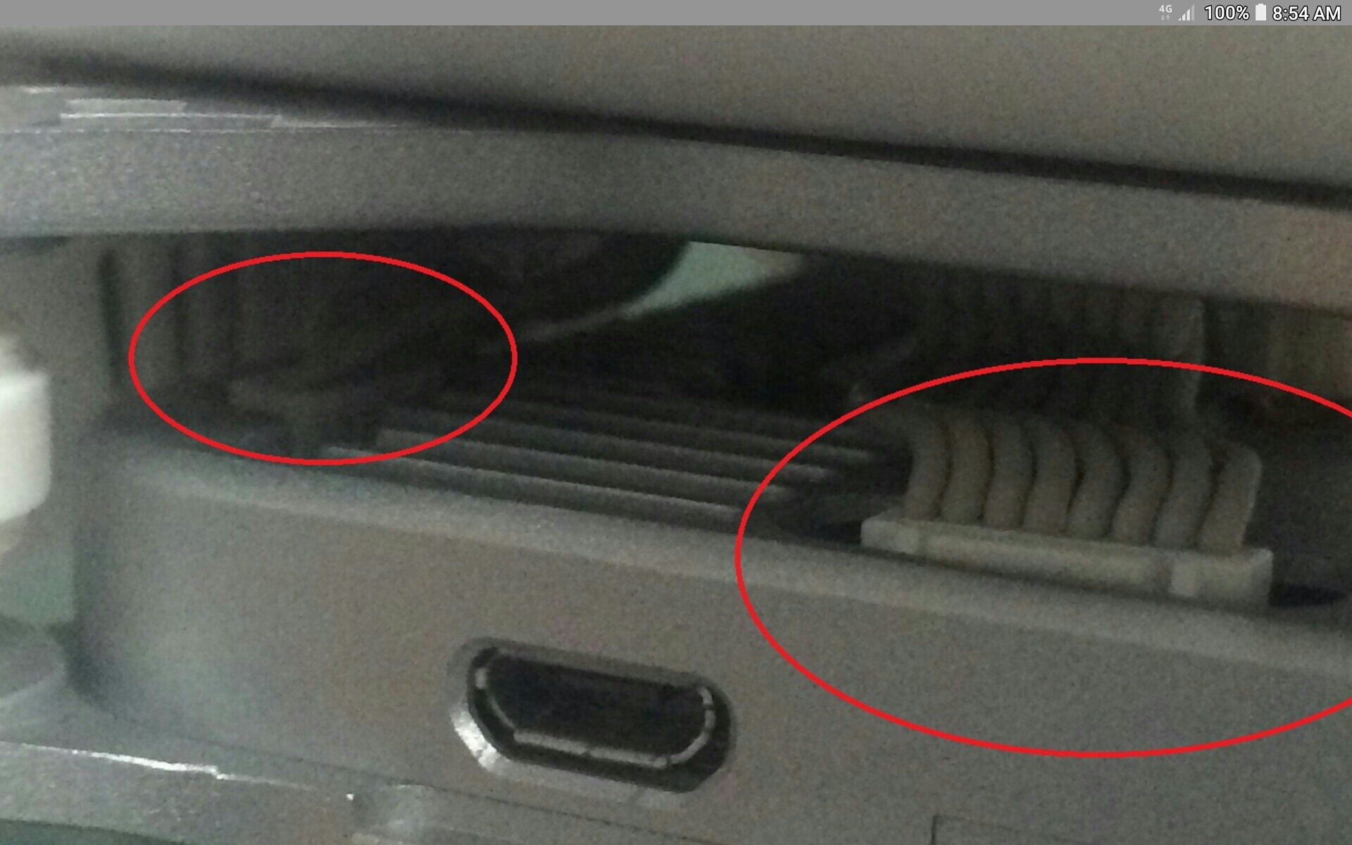

OK with you now,yes it shutting down after start up,,is cam or gimble getting warm or normal, all ribbons look good and in place ,is white plug in gimble board above cam nice and tight,,just going to have search cause yours stops after start which is odd
Sep 23, 2018
25
9
25
Yes, everything is nice and tight! Ribbons is a bit Dirty but that does probbably Not effect the dtone/gimbal.

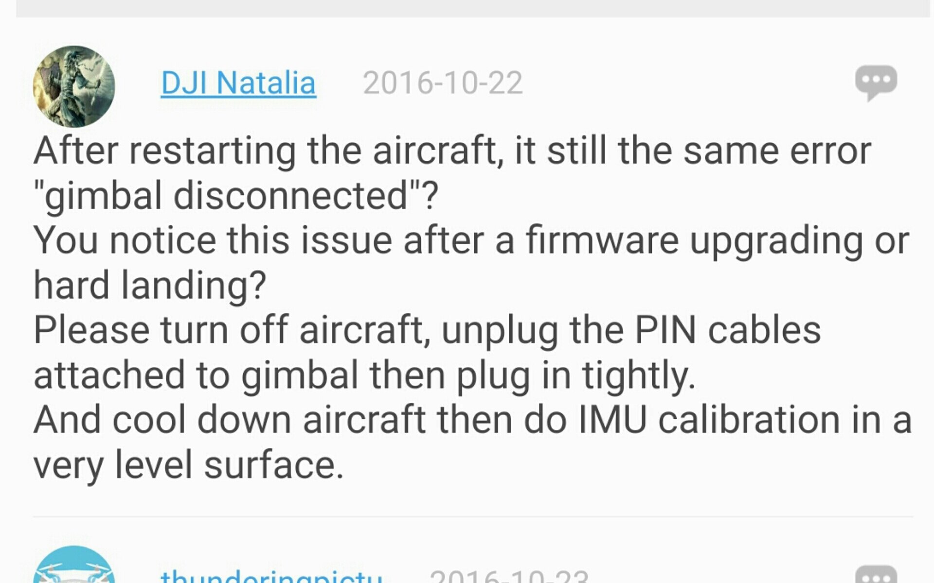

Did find this one saying to unplug and replug back in,have to disapear for 30min but be back,see what else I dig up
ianzone
Premium Pilot
May 22, 2016
5,004
2,589
49
NZ

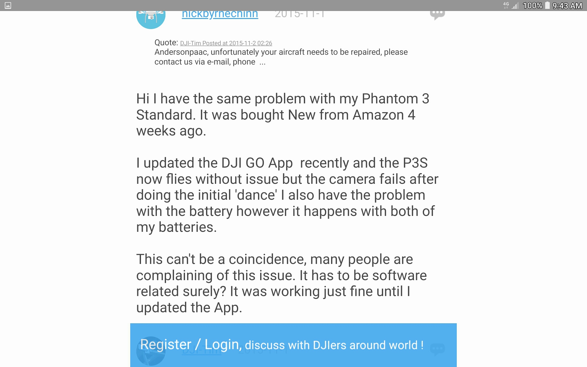

You not alone on this after big search ,couple had fix from above info I posted on plugs ,some been sent for repair,these are old posts in pictures so has been on going issue for some,,you could try the home screen where you have 3 black lines up top right of screen,,press these lines for couple seconds and you should get 1 or 2 firmware versions for remote,changing might make gimble and cam work again,,seems very simple fault but trying to find answer goes around in circles,,unfortunately one fix does not solve all phantoms which shows how different they all are (just talking p3s range here)they don't all seem to get made in same factory or something or one fix would fix them all,to many combined parts made by the cheapest bidder I think,,,will update if find something else
Sep 23, 2018
25
9
25
Hi! No it dosent effect if im flying just testing it on the ground or dji go app not connected. And i have standard gimbal settings that means i have FOLLOW mode on. The video is now watchable!
You not alone on this after big search ,couple had fix from above info I posted on plugs ,some been sent for repair,these are old posts in pictures so has been on going issue for some,,you could try the home screen where you have 3 black lines up top right of screen,,press these lines for couple seconds and you should get 1 or 2 firmware versions for remote,changing might make gimble and cam work again,,seems very simple fault but trying to find answer goes around in circles,,unfortunately one fix does not solve all phantoms which shows how different they all are (just talking p3s range here)they don't all seem to get made in same factory or something or one fix would fix them all,to many combined parts made by the cheapest bidder I think,,,will update if find something elseView attachment 103894 View attachment 103892
