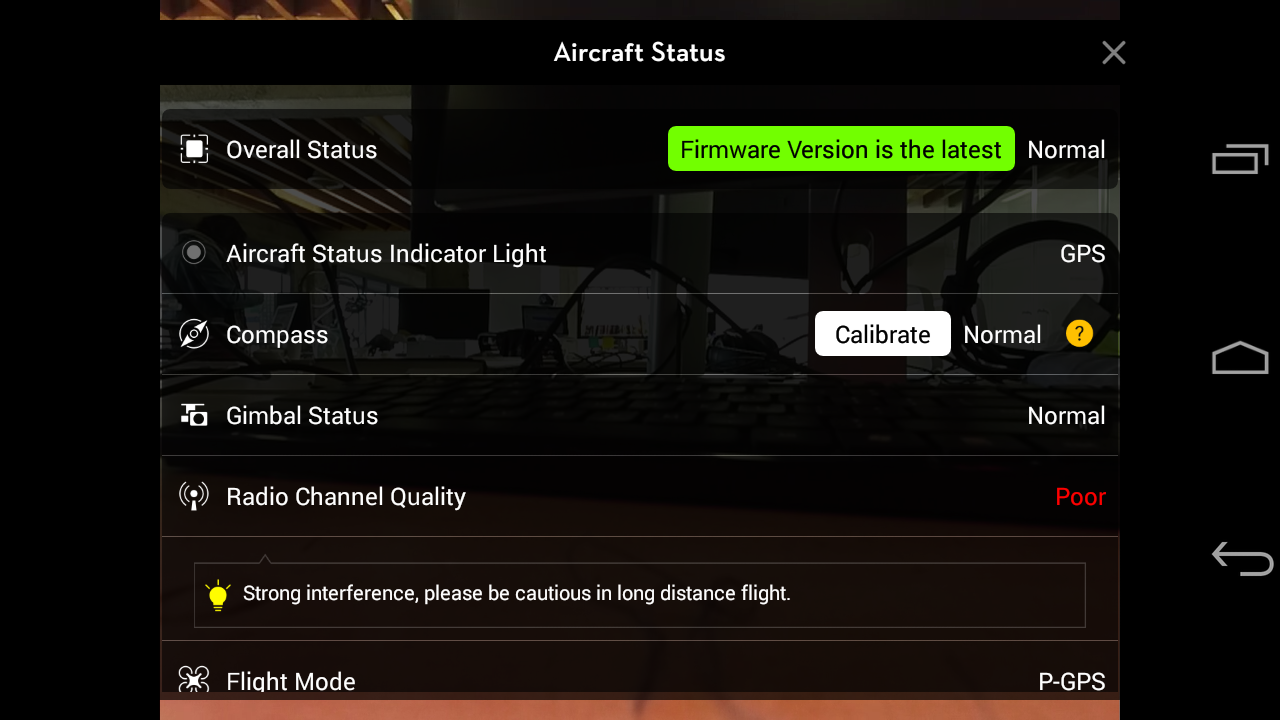

    This is the issue i am having. I cant connect wth?

    Correct me if I'm wrong, but it's telling you right there that you need to connect to: PHANTOM3_05e7f1
    Open your Wi-Fi settings on your phone or tablet, and when you see PHANTOM3_05e7f1 in your list of available hotspots, connect to it. Password is: 12341234 (unless the person you bought it from changed it and didn't tell you). You can also change this in the app.
    Also, charge your battery. This **** P3S is so finicky that low battery (RC, drone, & phone) can play a factor. Also, try uninstalling the Go app and reinstalling. Again, once you re-install, turn on the RC, then the Drone, then open your Wi-Fi setting and connect to PHANTOM3_05e7f1. Next open the Go App and connect to the P3S (click on Enter Camera View). If this still fails, then I think you're SOL, sorry.
    Oh, one more thing, experiment with disabling Google Play services as well. This has been an issue and causes the app to crash for some people.

    Im connected

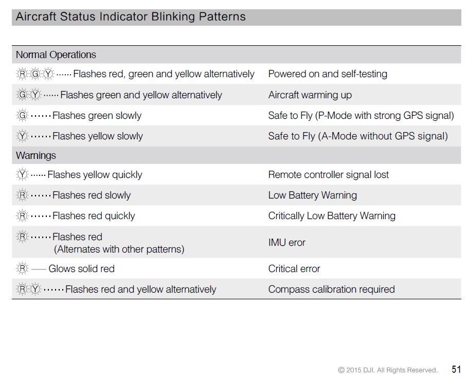

    Lol...k so i got it updated by using an ipad .. it said success but now 2 of the leds are flashing green and the other 2 are solid red.. dont know where to go from here?

  14. johnny rod
