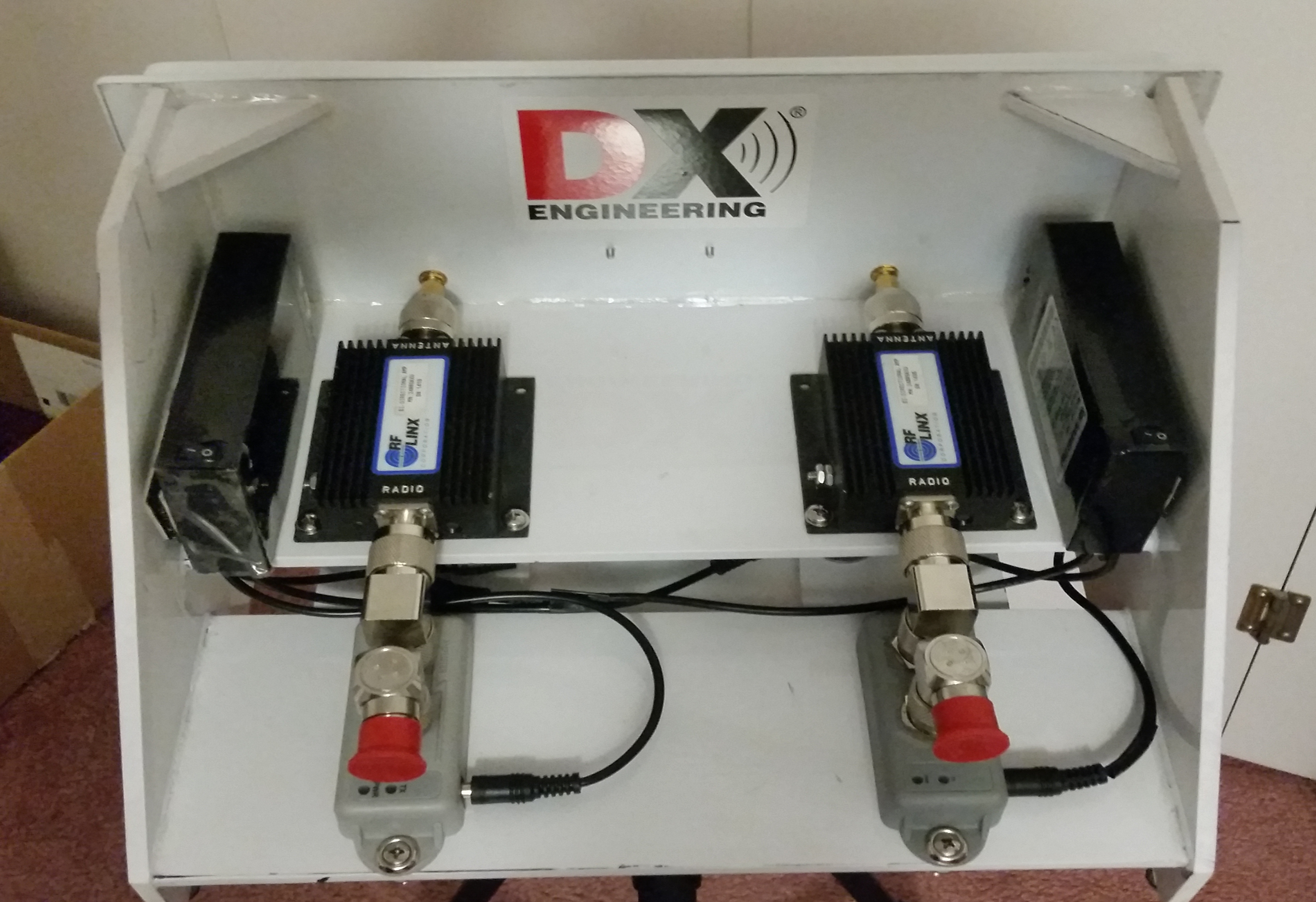

Pic of the antenna which is the RX magic

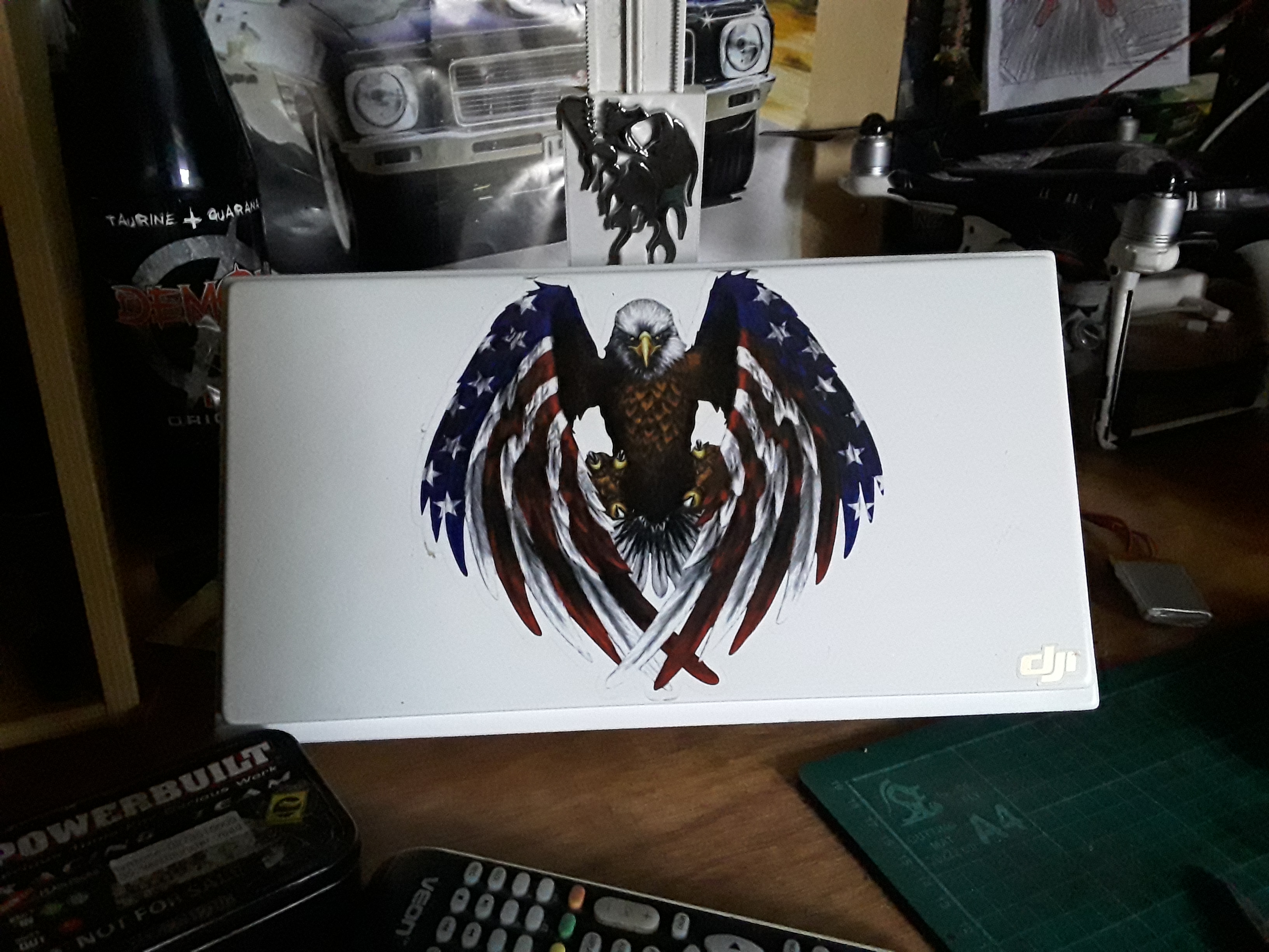

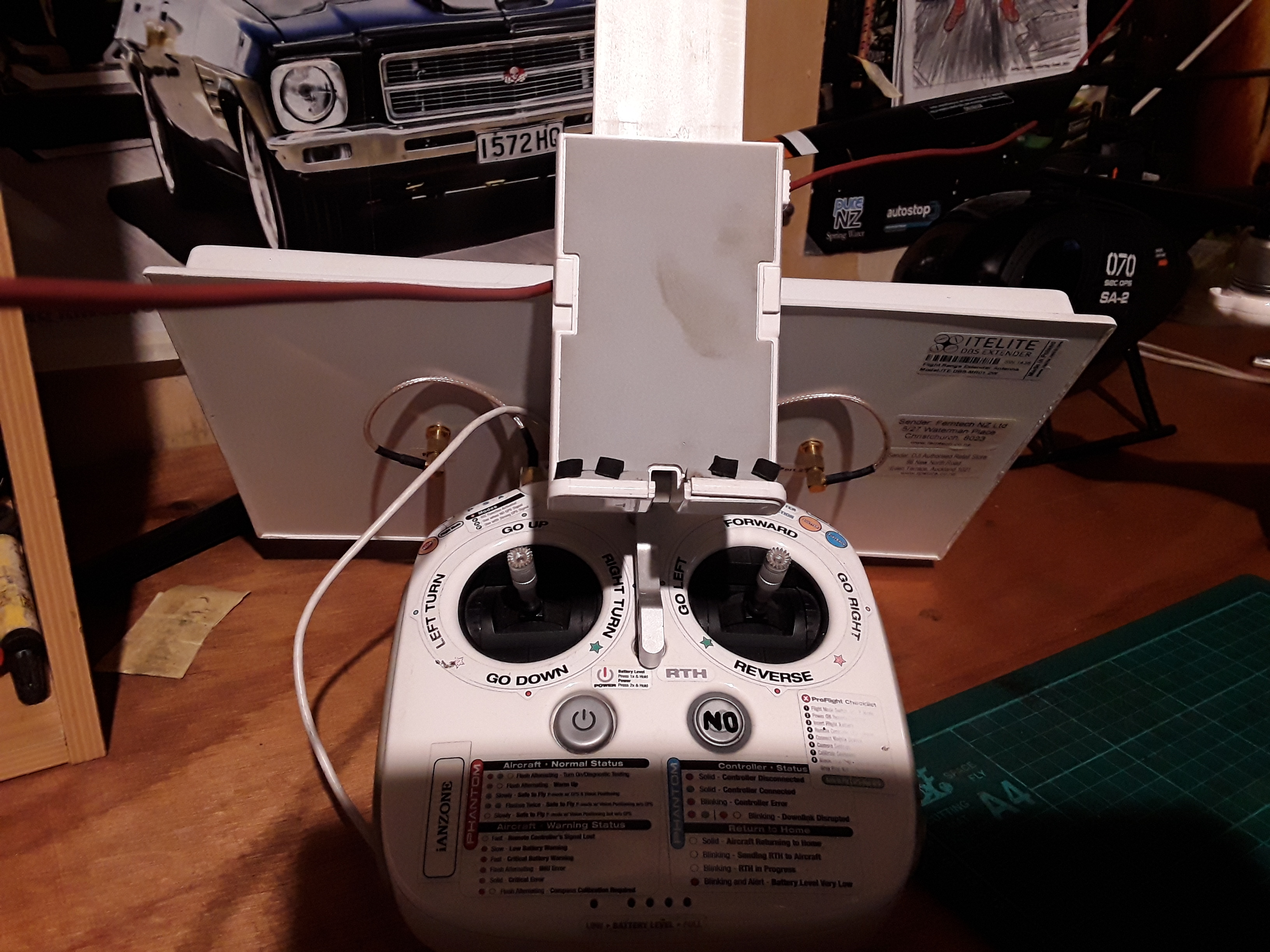

This my panel, is this the starting point :)

You are using the same antenna panel I am. Adding amps would set you back from $100-$150 (Set). Control signal is not the issue, RX signal is all the issue, so when looking at amps, look at the specs of it's RX Db value (Higher is better). Most offer around 11-13db RX. The ones I use from RF-Linx have 20Db RX. So video feed has a much better chance of maintaining a link.
I do offer a tip: Use heavily shielded cables from controller to antenna. Those appear as RG-316. MAXXUAV sells RG-58 usually, but he is currently out of stock.
See this link: Short - High Quality Antenna Cables RG58 (3.5" or 90mm)
This is an exellent antenna as well as it's smaller brother.
(Love how you spelled "NO" on the RTH.....)

did you print out your collection of instructional stickers or buy them online somewhere?
HI do a search on amazon and this come up,,they used to be on ebay but couldn't see any today

HI great info,I think I already got some of those ,these ones 110mm long,the amps seem reasonable on the price,still early here but will have a search around today,,lol yes I don't like rth,that button never gets used

As a ham radio operator I had to chuckle as soon as I saw the DX Engineering sticker. I have one of their catalogs on my table.
