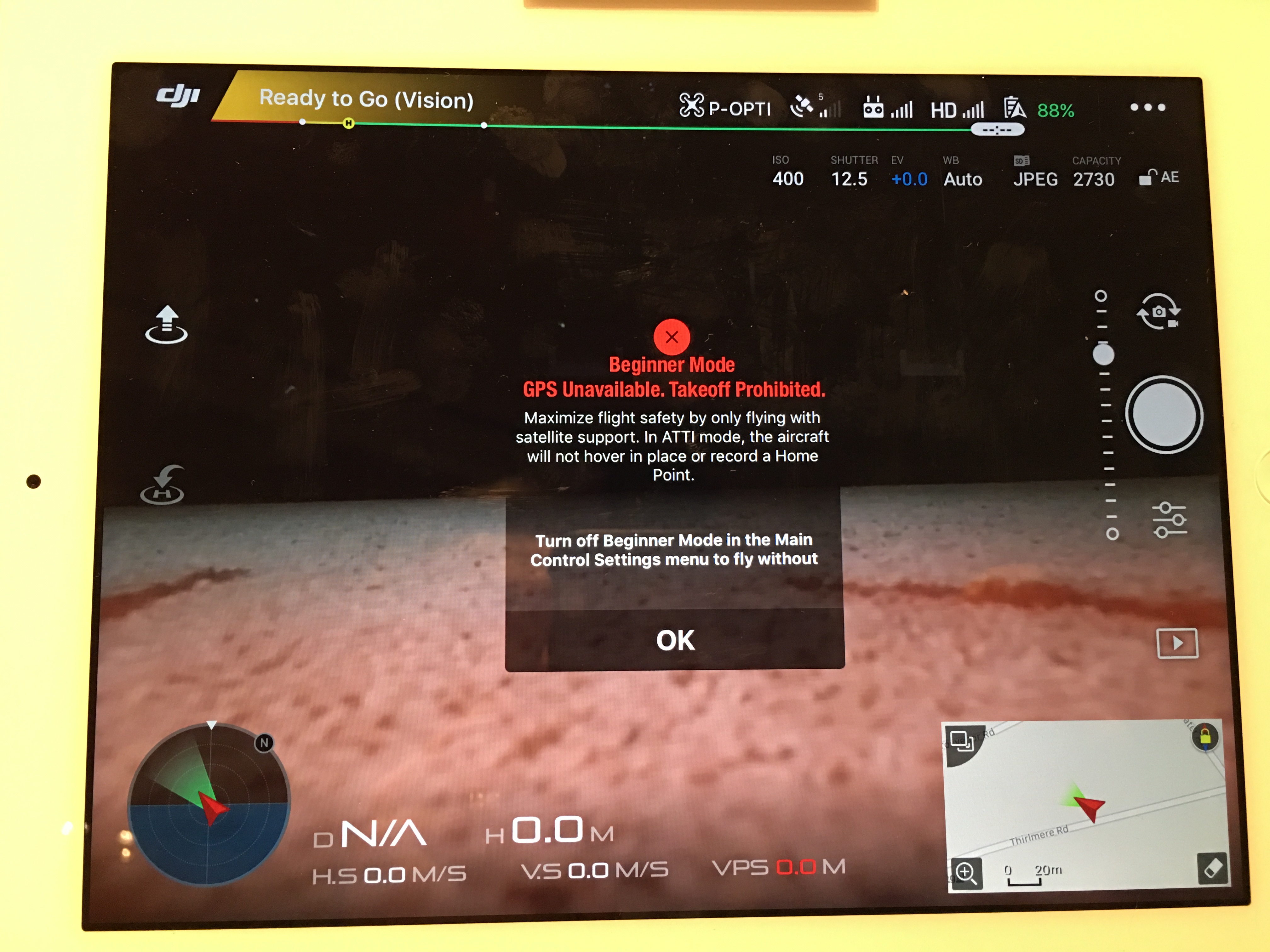

I have Phantom 3 advanced, been out a few times in beginner mode no probs, however went out today and the Phantom would not start up in beginner mode ? I had to turn it off.
Can someone explain why this has happened ?
Did you have a good GPS signal? If not, the motors will not start when in Beginner Mode.
I keep getting the following message - so no!
Check out the GPS signal at the top of your image. Your Phantom was only connected to 5 satellites at the time.
Msinger and ianzone I thank you for your assistance as I thought I had switched something on by mistake.
