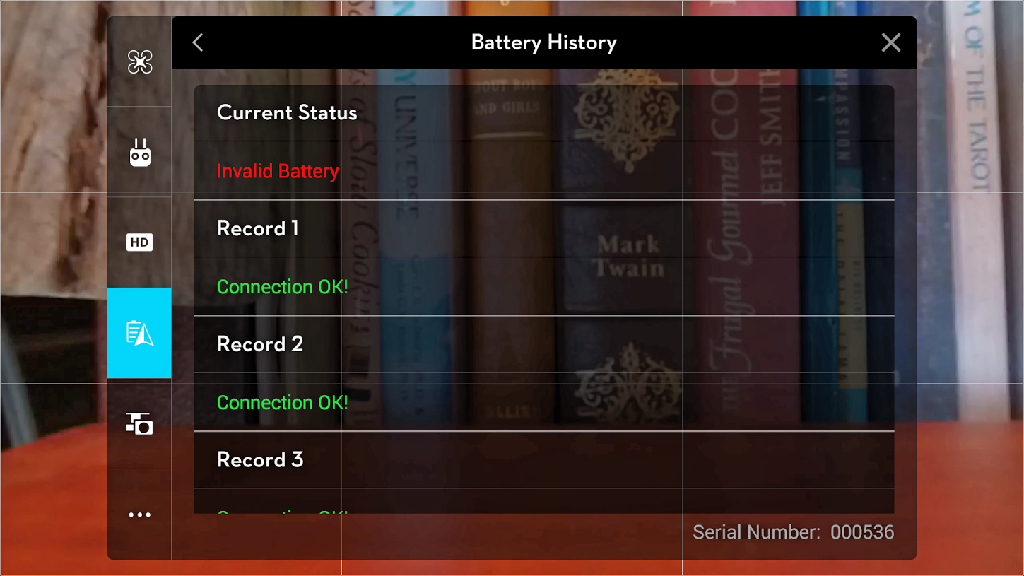

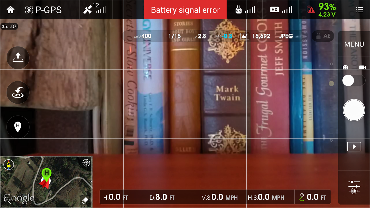

    I have the same issue, second battery "battery signal error" (never flown battery by the way). It's pushed in all the way, as it boots up. One screenshot of the battery History says "Invalid battery" along with a serial number. total of 3 screenshots
    What I've done so far:
    a. latest firmware installed, aircraft, batteries, RC
    b. booted up aircraft without RC, to let firmware re-write to suspect battery
    c. tested other battery and flown with it no problem.
    thanks!
    Everett
  6. bbfpv
    Feb 3, 2015
    3,858
    1,153
    Long Island, NY
    The quad will still start up even if the battery is not in all the way. We're talking a millimeter, not "oh i forgot the battery, doh!". If that's not it, you have a bunk battery and should send it back.

  7. theFlyingHawaiian
    Aug 25, 2015
    2
    the battery is seen by the quad and rc...quad engines won't spin up with that particular error message....does look like a bad batt. thanks
