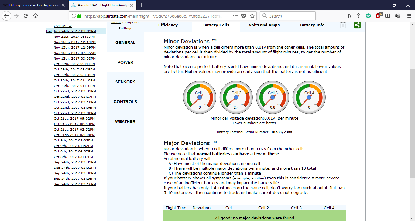

Thanks, I do use that, but my freind is s new user and is buying an aftermarket battery and I want to give him some in flight insight into potential battery issues.You may wish to look at Airdata/UAV (formerly Healthy Drones). You can open a free account. Following is a sample of the Power screen.
