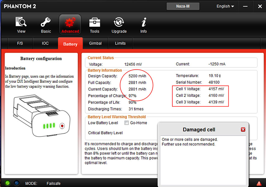

That's a problem with what you read in these threads everyone has an opinion whether right or wrong. .What you should be concerned with is the condition of the battery itself not the percentage of life.
The only way to really know what condition your batteries are in is to pop them into your P2 and connect the software.As you can very well see this has 90% life and was 15 months old but has damaged cell error message. Check current and charge readings there's the real problem. Did the battery fly the P2 yes. Did I return and change batteries better believe it. I also have two batteries which are two years old that have 87% life cycled 47 times That I do not use because there only good for 6 minutes of flight and auto land at 15%. If i landed at 30% like most do the light would be around 3 minutes in the air.

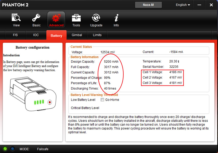

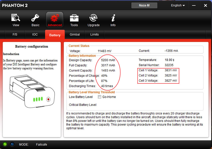

Here's what a 2 year old battery looks like before and after charging.
If you noticed the discharging times didn't change and it should have

It's been surmised in the past that until 5200 mah has been 'drained' it will not increment.
Is that no longer seen as the case?
Oct 12, 2014
5,180
577
Commerce Twp,MI
That seem to be the case with this battery. But I only charged it as demonstration as it is 2 years old and had no intent to fly with it.
