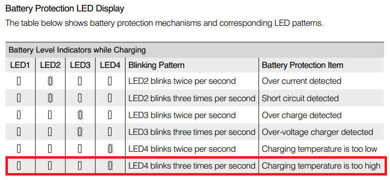

I purchased a phantom 3 4K about a month ago and have about 12 flights. I noticed that my battery is very warm.....almost hot when a remove it. I also fly a phantom 2 vision and have never noticed any battery heat and longer flight time as well. Also when I charge the phantom 3 battery it begins with about 5 seconds of the normal 1st and 2nd lights flashing, then goes right to a steady flashing 4th light by itself. Is this a malfunction indicator? Maybe because it is too warm/hot to charge? Help!!!!!
