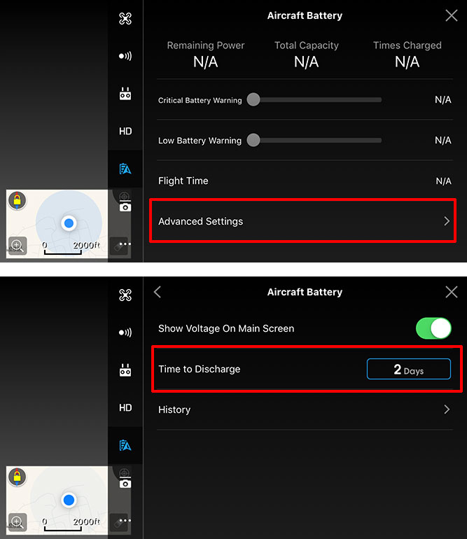

- Power up your Phantom with each battery installed and set the "Time to Discharge" setting (see the screenshot below) to the number of days you'd like your batteries to wait before starting to auto discharge down to the storage level. You'll need to reset this setting after new firmware is installed on your batteries.
When your batteries are idle (meaning you don't press the battery button), they will start to auto discharge after that number of days has been reached. It could take a few days for them to auto discharge if fully charged. Pressing the battery button at any time during this process will cancel the auto discharge process and make your batteries wait that number of days before attempting to discharge again.
