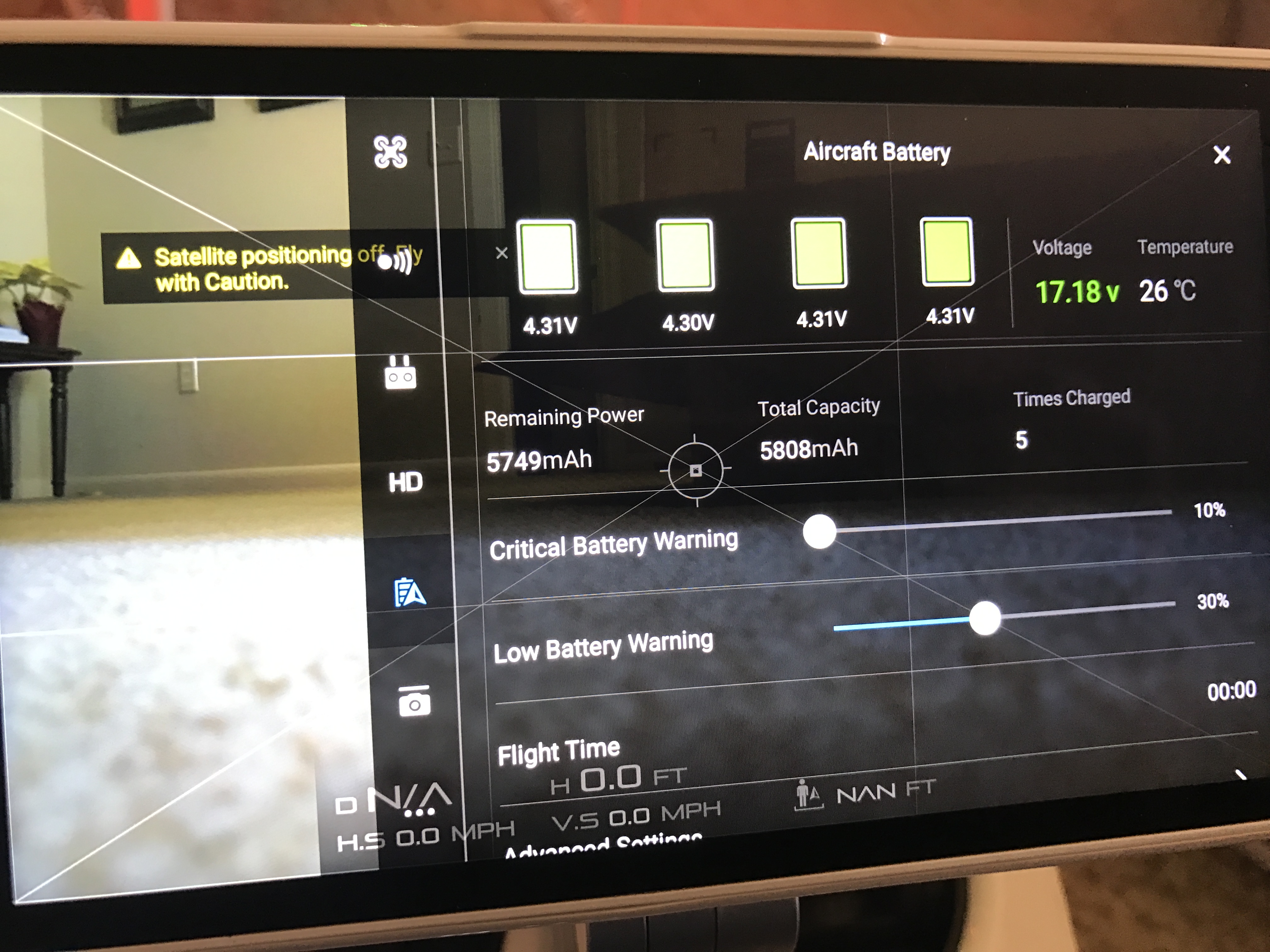

Anyone noticing this after updating high capacity batteries to new firmware?
There have been several posts in the past about DJI (either in the app or firmware) not recognizing non-OEM batteries. Looks like you go bitten.
****. I originally updated the craft with one of the old batteries. I then put the high capacity in and updated the battery from the RC, after which the issue started.
Now I'm afraid to update any of the other batteries.
I wonder if reflashing the firmware will fix this. I just don't want to lose all of my settings again
I didn't get any errors like that when I updated mine yesterday. Did you try to restart the aircraft as the error suggested?
Absolutely. Only thing I haven't tried and don't want to is to reflash through DJI assistant
I think you need to do a firmware "refresh" with DJI Assistant using the wrong battery if possible. This can solve your issue.
To do this you must be sure the battery can work at least for 15min... otherwise you fu***k your aircraft...
