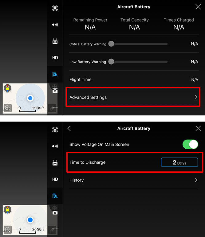

    This is an automatic process. As long as you don't press the battery button, the battery will start discharging after it has not been used for the number of days set here in DJI GO:
    After the discharge process starts, it'll take about two additional days for the battery to discharge down to 65%.
    Note: The above setting needs to be set in DJI GO while each battery is installed and your Phantom is connected to DJI GO. It'll also need to be reset after installing new firmware.
    DJI removed this recommendation from all of their manuals. You don't need to do this unless the battery cells are really out of balance.

    Cheers ... Thanks for that .. just one question. I fly or will at least every Tuesday on my off day. Lets say, I fly the batteries down to 10% ... do I leave them there till the next Monday night and charge right up?
    Let's say that I intend going out on the Tuesday and I can't fly, due to the weather .. can I 'tell' the battery to discharge over the next 3 days' ... or should I let it discharge 'normally' over the next 7 days.

    The batteries will last longer if you store them between 30%-65% charged. So, it would be best to charge them up until at least the second light starts blinking.
    No. But, you could set the above setting to 2 days. That would be a good setting to use since you usually only fly once per week.

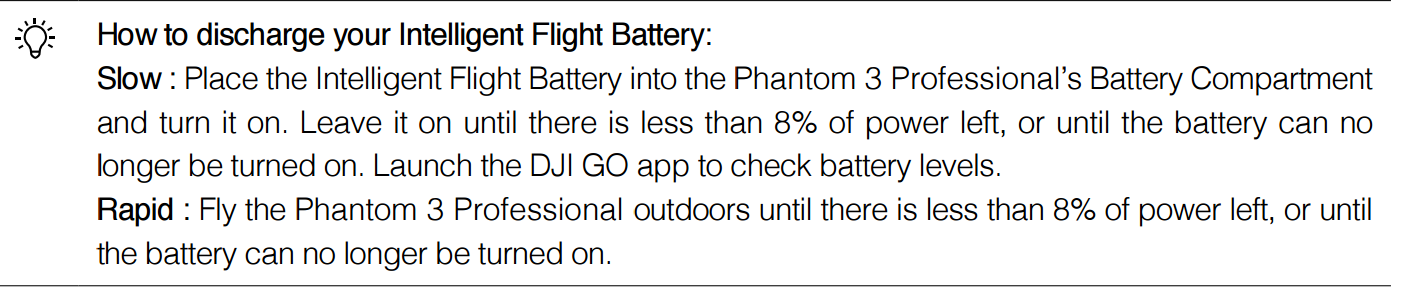

    The removed the information on when to take it down to 8% but they left this in the manual:
    It does not make much sense to explain how to discharge a battery and not mention _when_ to do this. Also, why wait until cells are out of balance when you can avoid this by discharging every 20 cycles or so. I'd say it's not important to do it every 20 cycles but I'd recommend doing it every so often.
