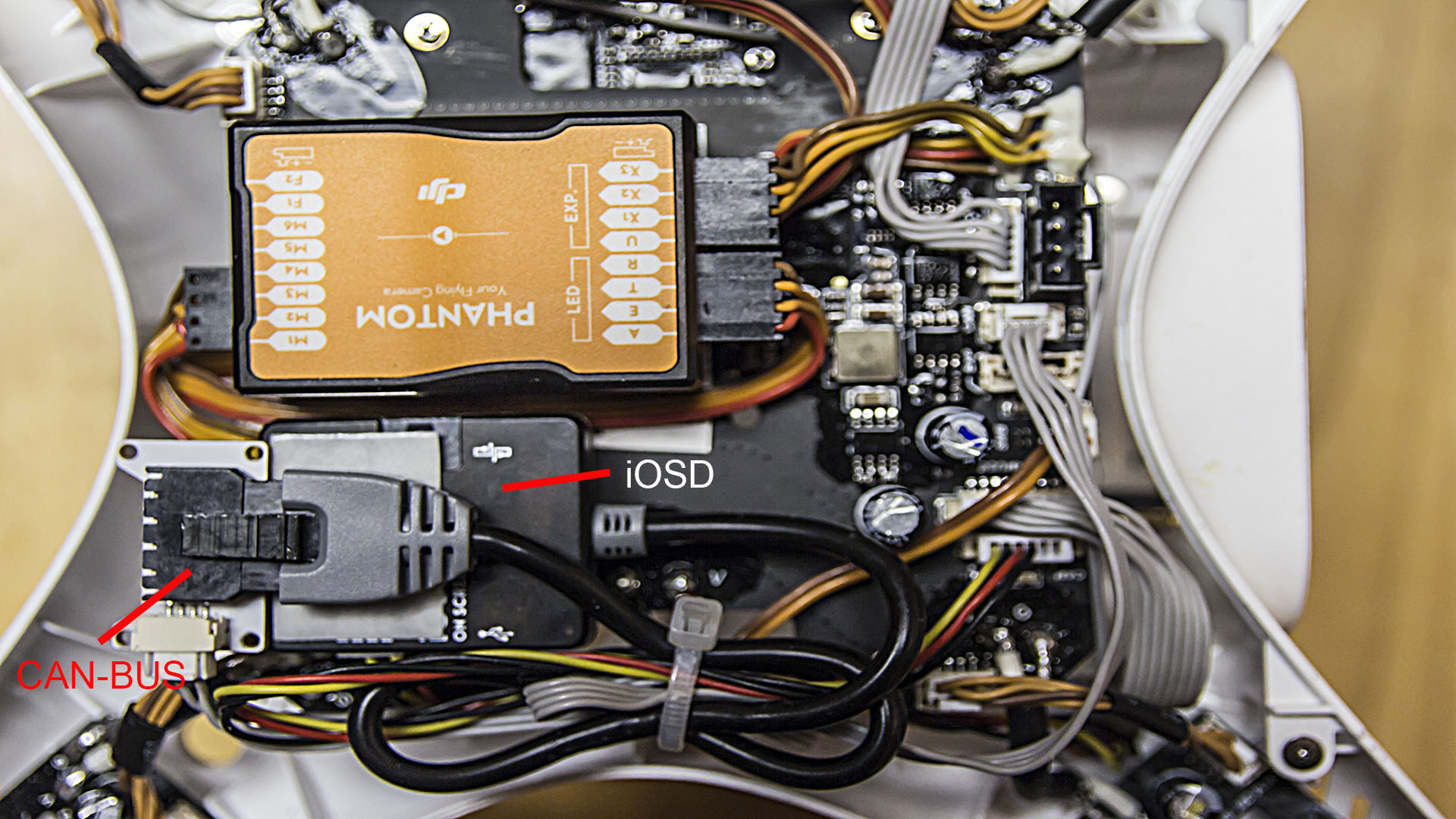

    I put both the mini iOSD and the anti-interference board inside the shell with only the TX and gimbal outside as it makes for a clean look and less drag. Here's a photo of the mini iOSD and a video for the interference board install.
    Khan likes this.

    Thank you once again, you're very helpful. I think I'll do installation like you did. Lightbridge is too expensive for me :-/
