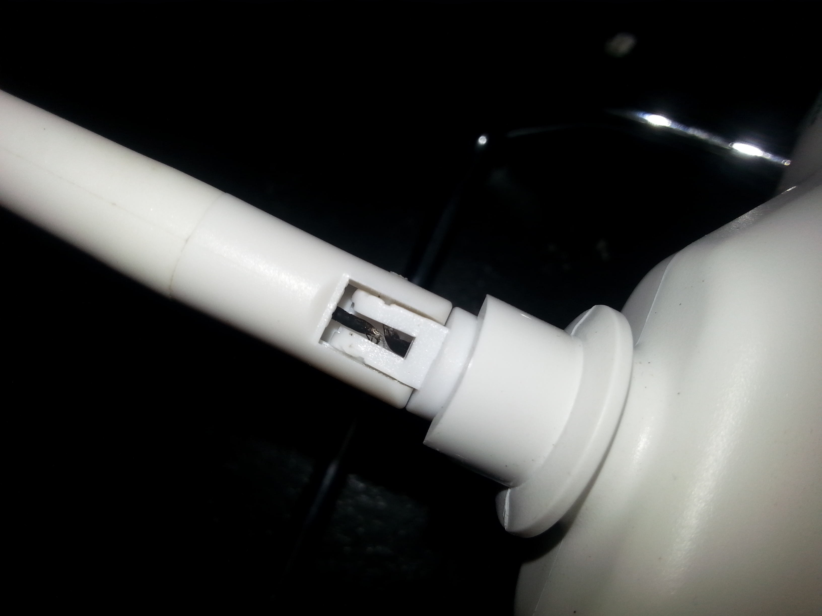

    So the antenna wire on my Standard broke. Not sure how but I just noticed it when I went to open the antenna out and saw it. See picture below. I found an antenna part for the standard but I'm not quite sure if it's what I need. It looks about right but I'll let you check it out. Here is the link to the part: Buy Phantom 3 - Receiver Antenna 5.8G (Sta) | DJI Store

    Wrong antennas bro . Hold on and will see if I can find what ya need .

    DJI does not sell that antenna. Try contacting a repair shop. They might have some spares laying around.

    Nope ...like msinger said or a member here that has modded theirs and still has that you can get maybe it's time to step it up and
    get a better one :)
    You gonna have to go in it anyway to fix it or send it off .
    This is the second one I've seen so far to break .
    From going in mine that cable is almost to short or was in mine and looked to me like too much moving it back and forth
    was the cause of it to break . Mine was stretched all it could . No Slack .
    Hey...upgrade ;)
    Just my thought :)
    If ya don't do anything in a couple of weeks I will send ya mine as I'm putting the itelite on mine .

    Upon taking it apart, I did see that the wire is way too short. I don't understand why they did that. I might just go ahead and upgrade to a better antenna. I saw a couple videos of someone showing how to install a new one but had to grind out the opening of the hole so that there was no gap in the controller. Is there a good antenna where I do not have to do that?

    Yea I've been looking for it. It doesn't help that I'm on my phone lol. I already have the original antenna wire disconnected. I noticed in the picture from the outside that there are two wires going into the controller. I'm assuming one of them goes to the antenna connection but I don't know where the second wire connects. I'm such a newbie lol.

    You better get on a screen where you can see . There's 3 cable's . 1 5.8 which is the one that's broke and the other 2 are 2.4 . They will have to come loose also to hook up the itelite antenna panel .

    Ok, I was thinking that there might be three. The antenna one I know and the other two are the red and black wires next to it. I'll still look up the pictures if I can find them. I got the antenna off but I stop there til I know everything else.
