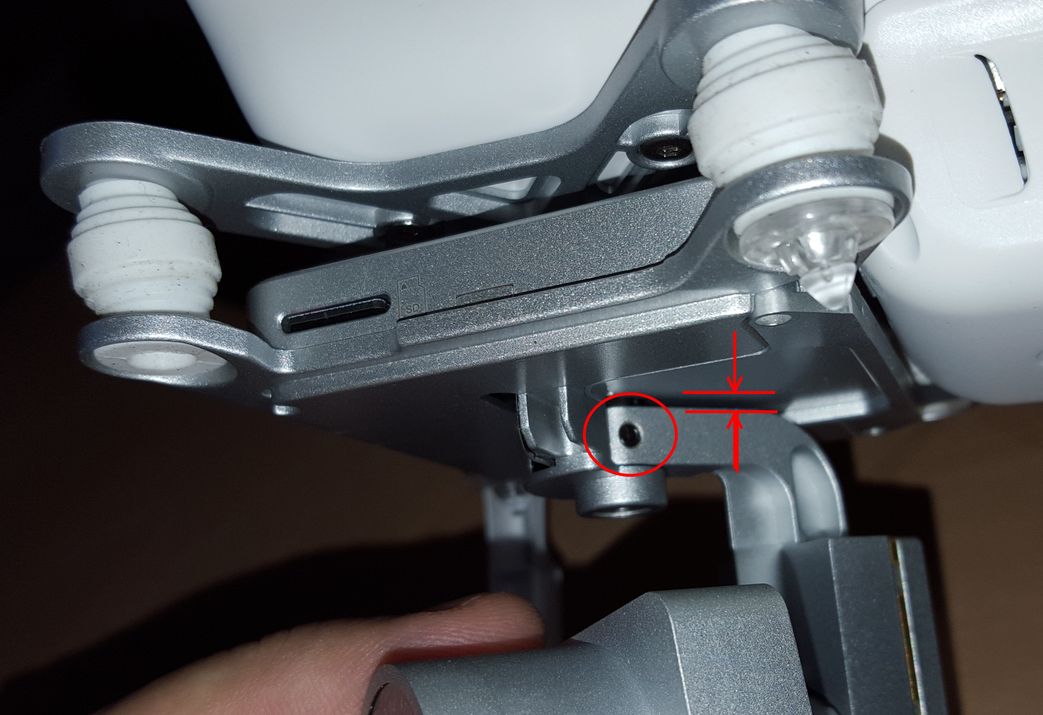

    There is a screw like in the bellow picture (red circle), it can happen that it become loose and then the controller of the gimbal can be crazy.
