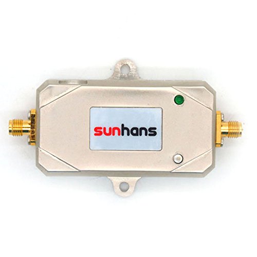

    For the pros out there:
    I have the amp shown below. I also have the P2V+ RE-700 extender on my controller. Somewhere I read about using this amp that the output of the RE-700 was too much for the input of the Sunhans amp and an attenuator had to be used between them. If correct, where can one be purchased?

    I've been using this same amp (slightly newer version) for over a month without any attenuator and it works fine.
    I believe the RE-700 maxes out at 100mW output and the Sunhans 2.4 GHz amp can accept up to 100mW (20 dBm) input as per it's spec sheet.
    I have the Sunhans Model SH-2500 (shown below) and your photo looks different than my amp --- so not sure if the input specs are the same? I assume they are.

    I have seen set ups where they mounted the amp under the controller and added a 12 V battery next to it. Have not seen where anyone used anything else. My version has a 6 volt adapter and will run off a 5 volt 12,000 MAh phone charger in my pocket.
    About the same specs. Mine will run on 5 volts. Most discussions I have found state the RE-700 just may overload the amp and actually cause less FPV distance. As with any electronic device, YMMV.

    I've had my P2V+ out to 2.5 miles before I lost control signal --- so I'm pretty happy with FPV distance using this amp (using a half-dome antenna from FPVLR.com on the output side of it as well as bird-side pinwheel antennas) :p The bird-side pinwheels make a HUGE difference --- probably tripled max. range compared to the stock FPV antennas on the Phantom.
    However, I'm a firm believer in empirical evidence --- so if you have the patience, just make a few runs with and without the attenuator on the same day on the same flight path and see what kind of results you get. That's the only to know for sure if the attenuator makes an appreciable difference in max. FPV distance. :)
