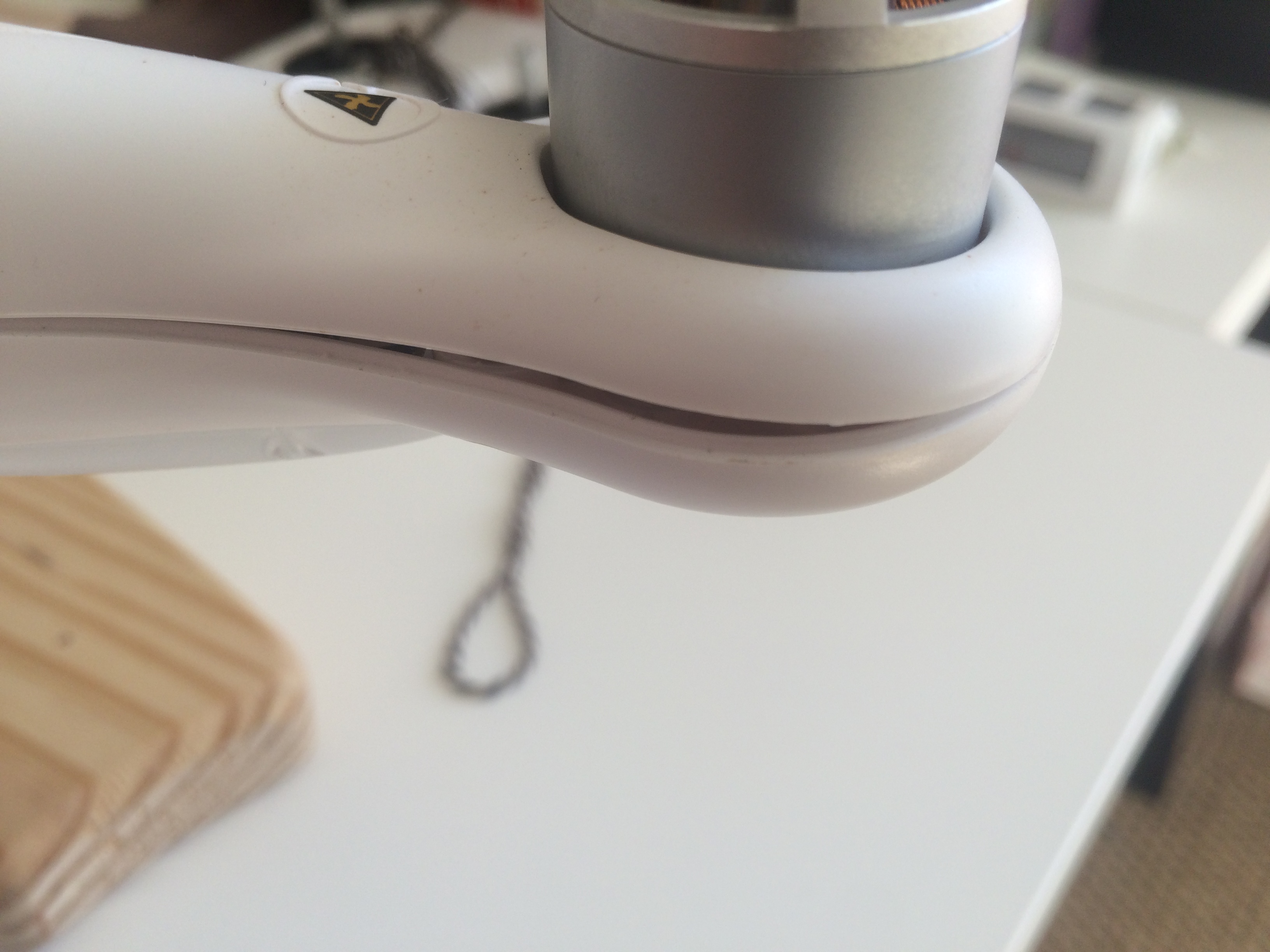

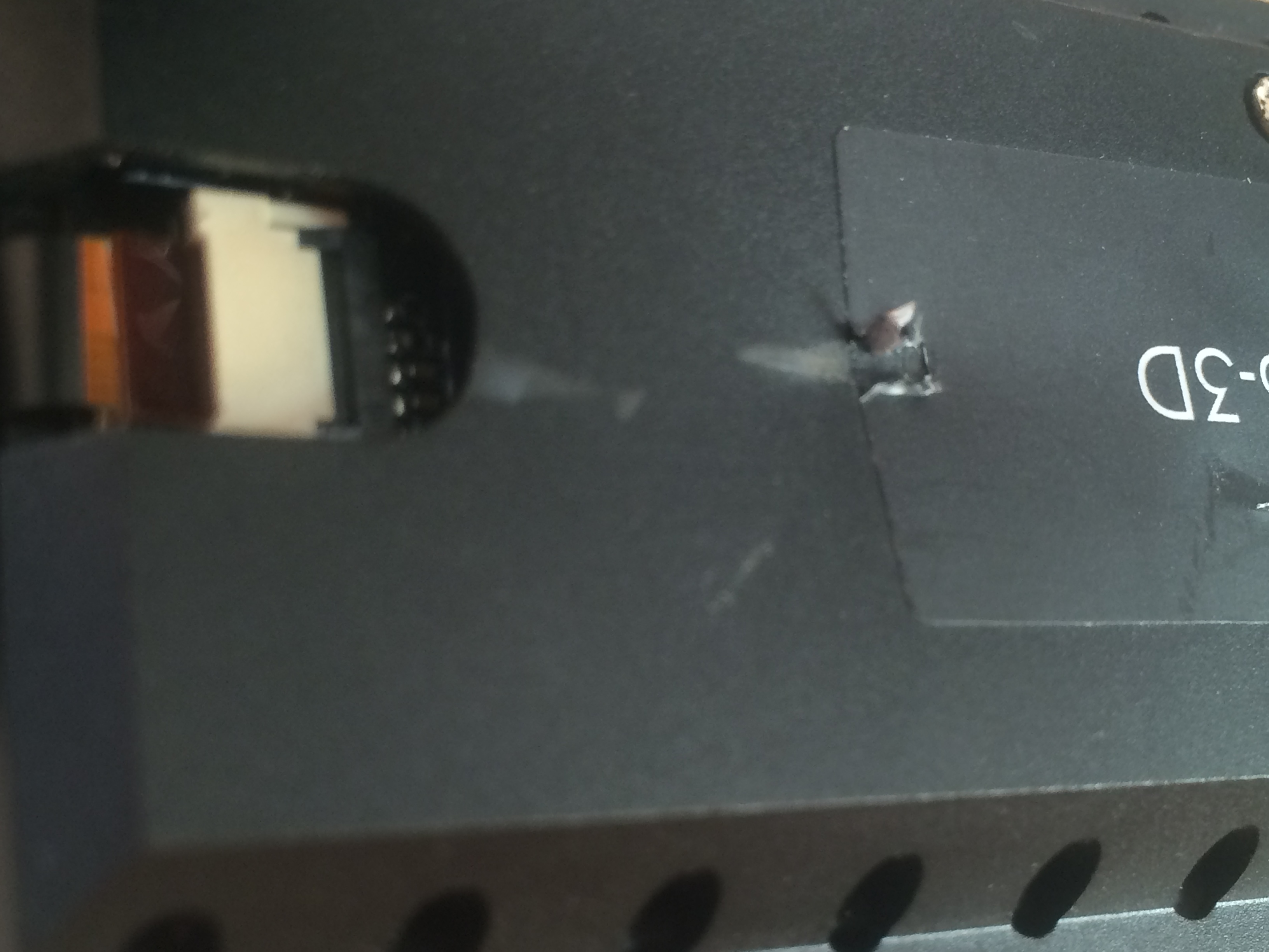

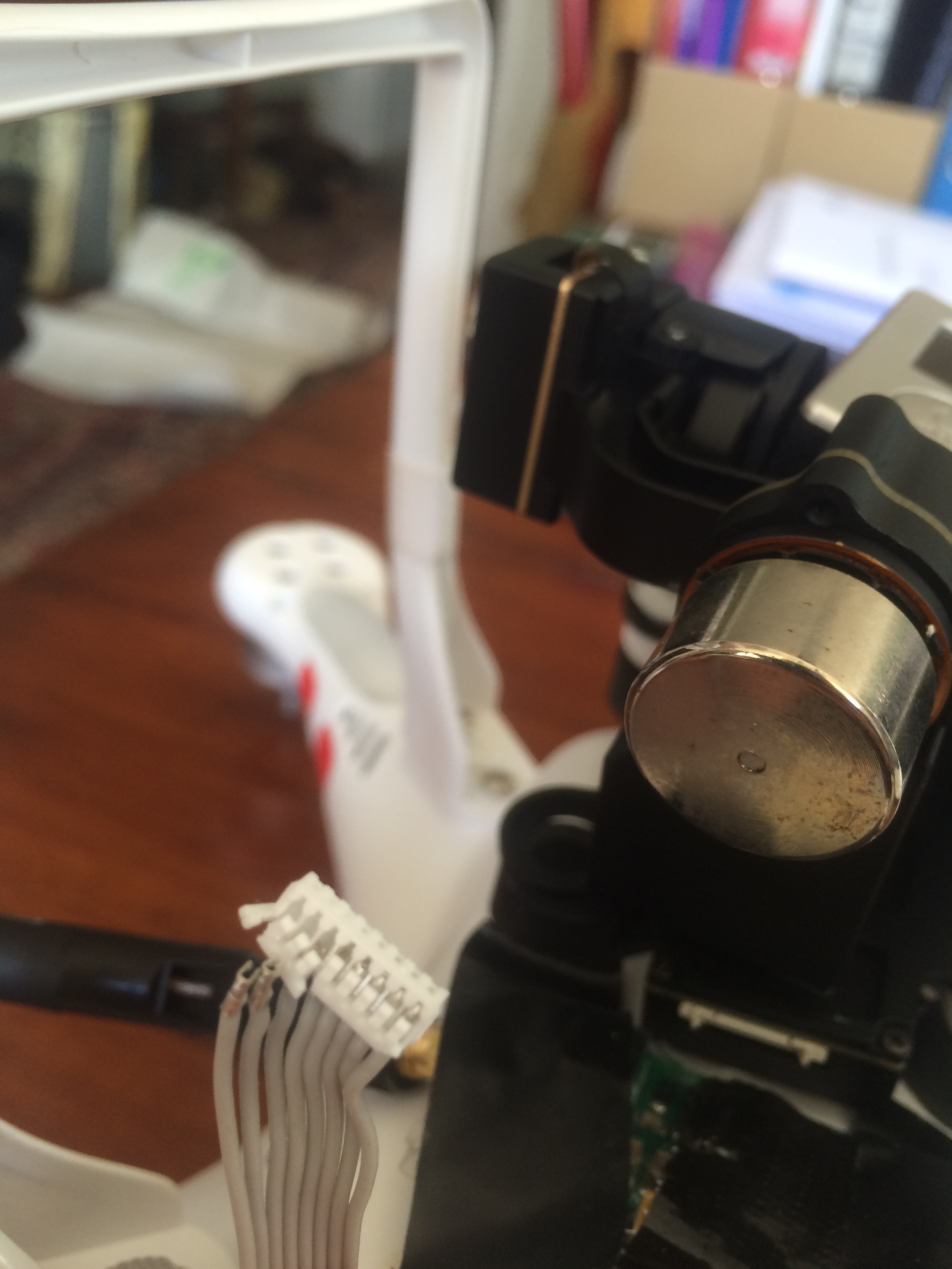

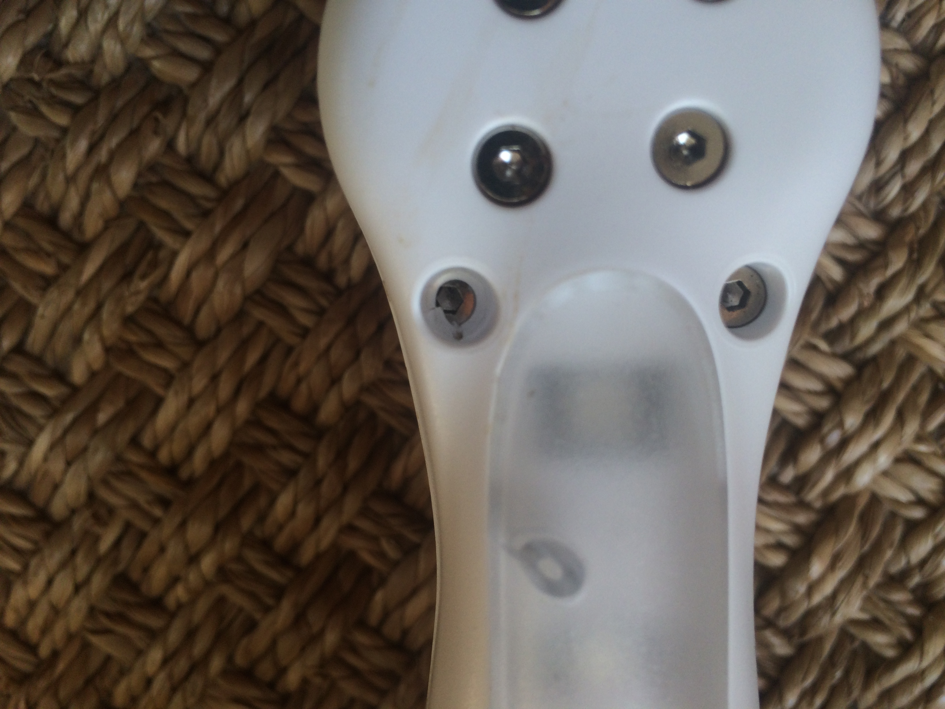

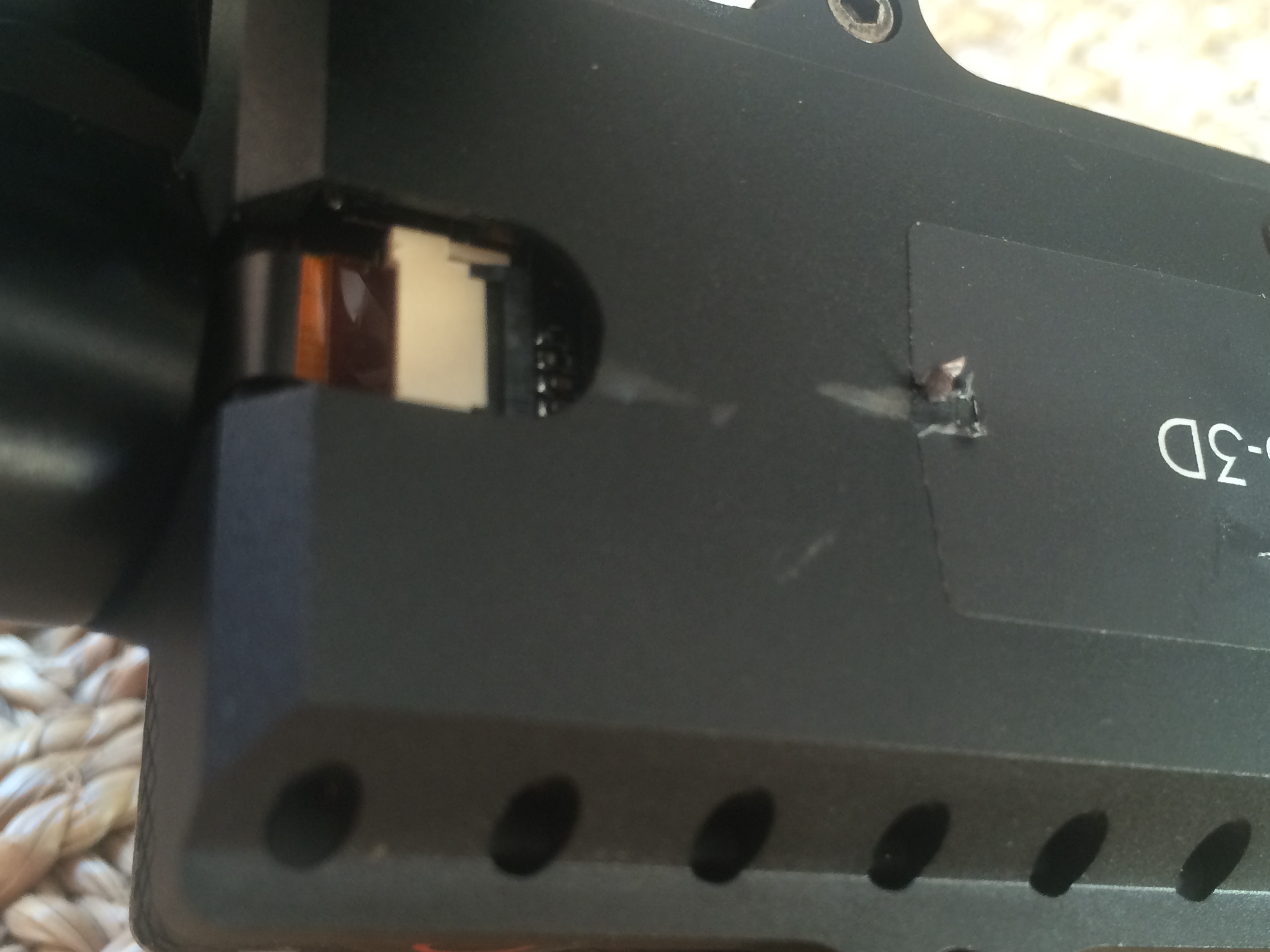

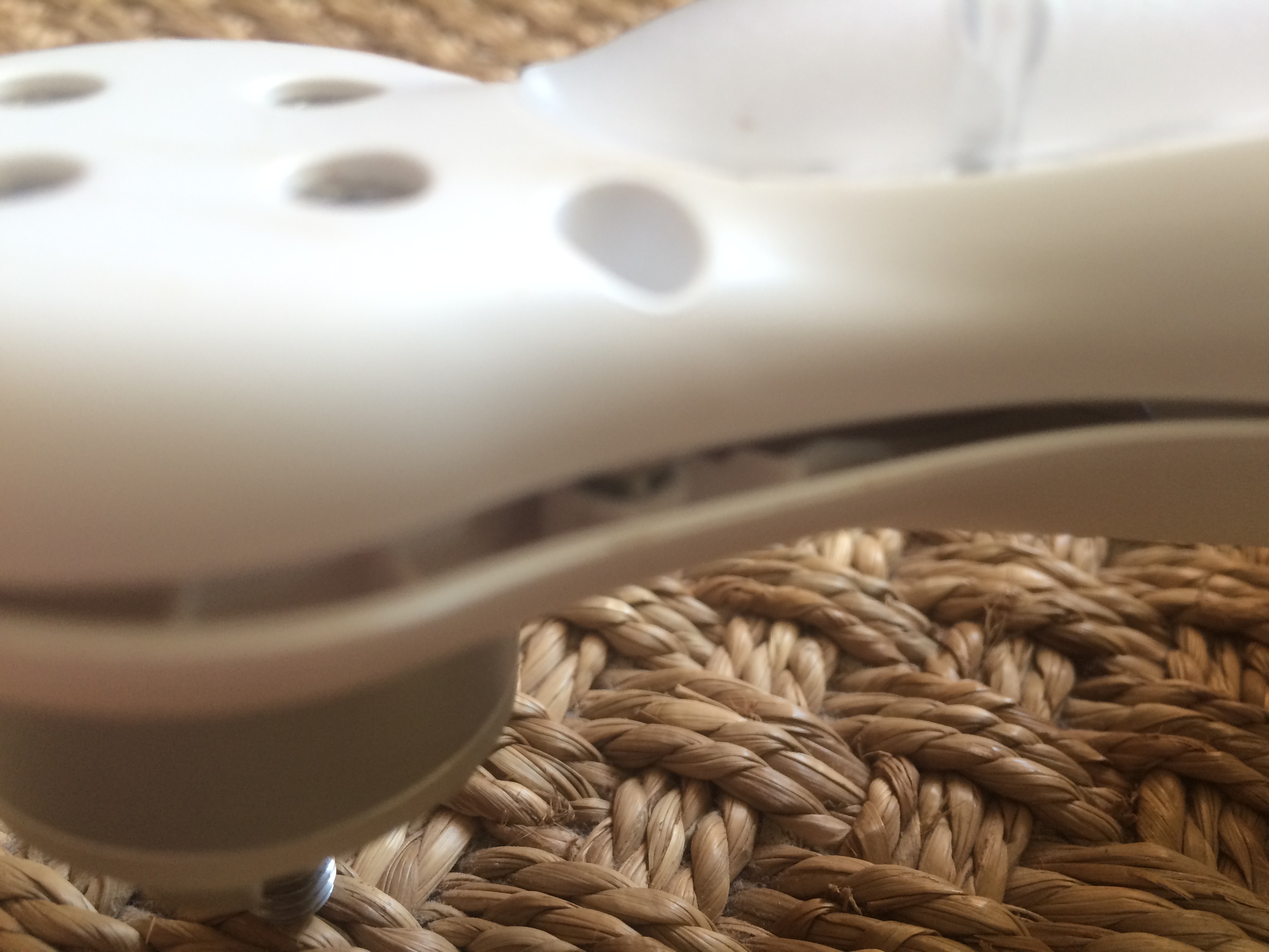

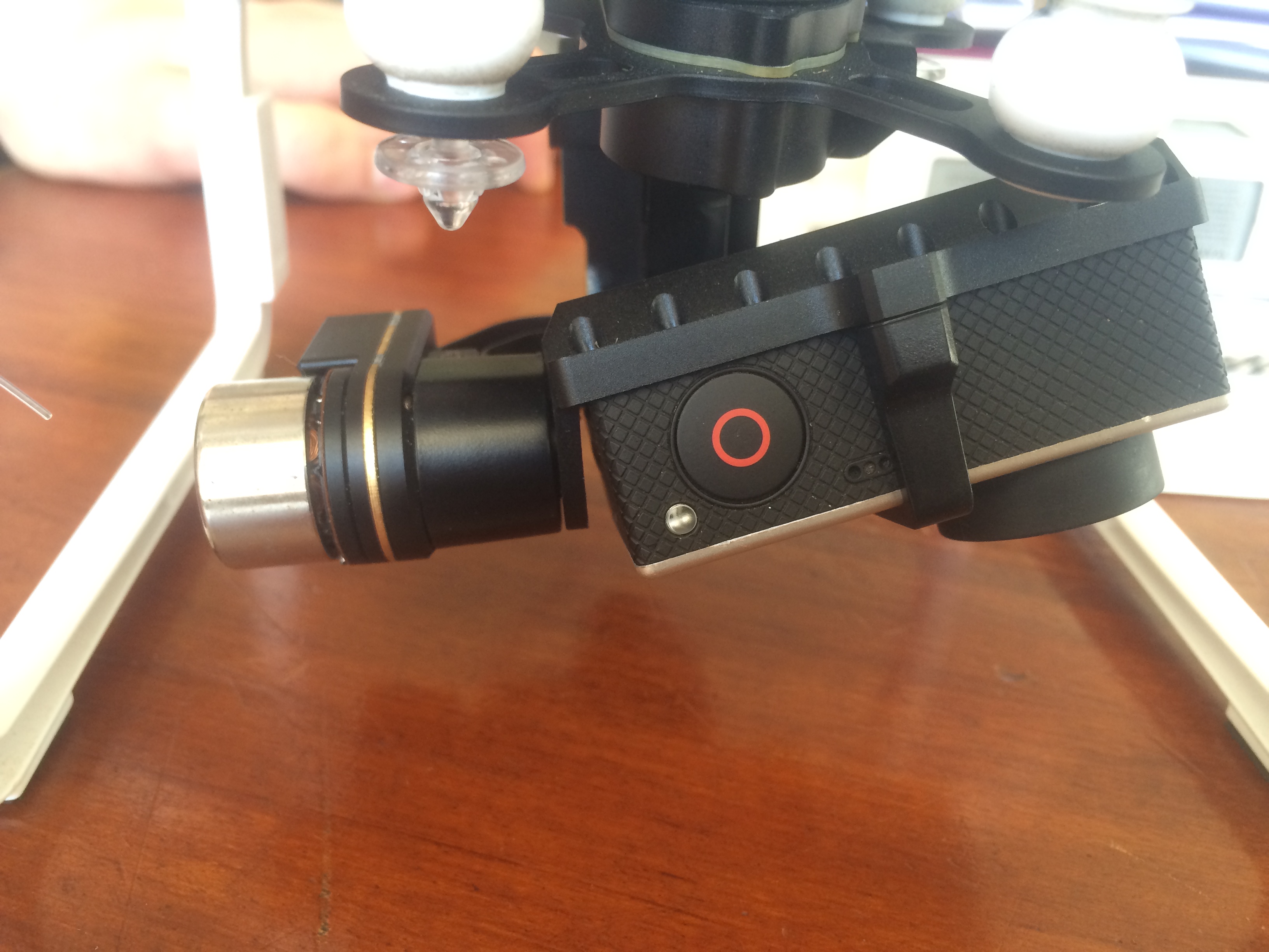

Good point. I have photos ready though, so here they are:
IMG_0947.JPG IMG_0943.JPG IMG_0949.JPG IMG_0941.jpg IMG_0948.jpg IMG_0950.JPG IMG_0951.JPG

Right now you need new shell, 6 pin cable and gimbal repair. So now open the shell an put a fresh battery reconnect the GPS cable and lets spin up the motors (this can be done with the props on as long as the P2 is weighted down) want to see if there is damage to the ESC modules.. Video tape this and post it on youtube make the footage at least a minute long.

If you have a good case that it was a manufacturing defect and it's 6 years the sale of goods act in the uk should cover you if you bought it in the eu, especially in the uk. I'd take what ever proof you have back to the retailer and make your case, if your sure it a manufacturing defect and you don't get a good response from the retailer you can make a small courts claim which is easy and cheap. I had a crash, my own fault, looked a lot worse than yours especially the gimbal. Every repair shop i contacted said it was write off, I bought a new shell and sent my gimbal from Ireland to to this guy...USDRONEREPAIR. The gimbal had lots wrong, it cost about 60-70$ for repair plus shipping. He worked wonders on the gimbal...check out his Facebook page and good luck.
Thanks a lot for the info! It seems that everyone seems pretty sure this is very much repairable by myself. Definitely new shell and gimbal repair... Is the USDRONEREPAIR fast? Because if I'm honest it may not take too long to put this thing back together. Jason, I am going to do your tests soon. And I will upload photos of my transmitter ASAP also. Why do we think it downed in the first place? I know that when I flicked the 'return to home switch' it instantly failed. Here is the video for you. I will get everything else done as soon as I can. Thanks so much for all of your help so far, please keep giving me ideas :D
