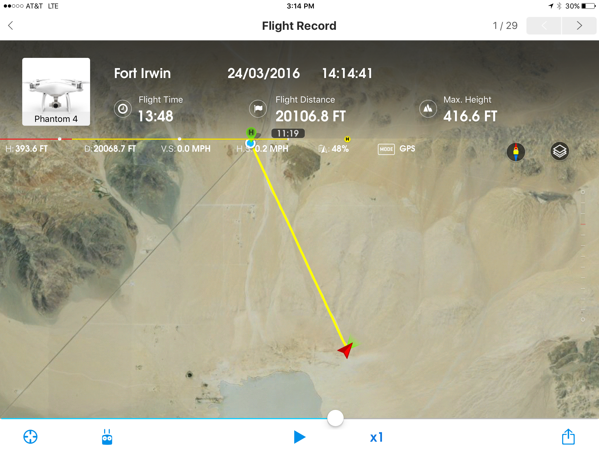

    In my noobish opinion, this is what 95% optimal looks like. I say 95% because I had 5-7mph crosswinds.
    [​IMG]

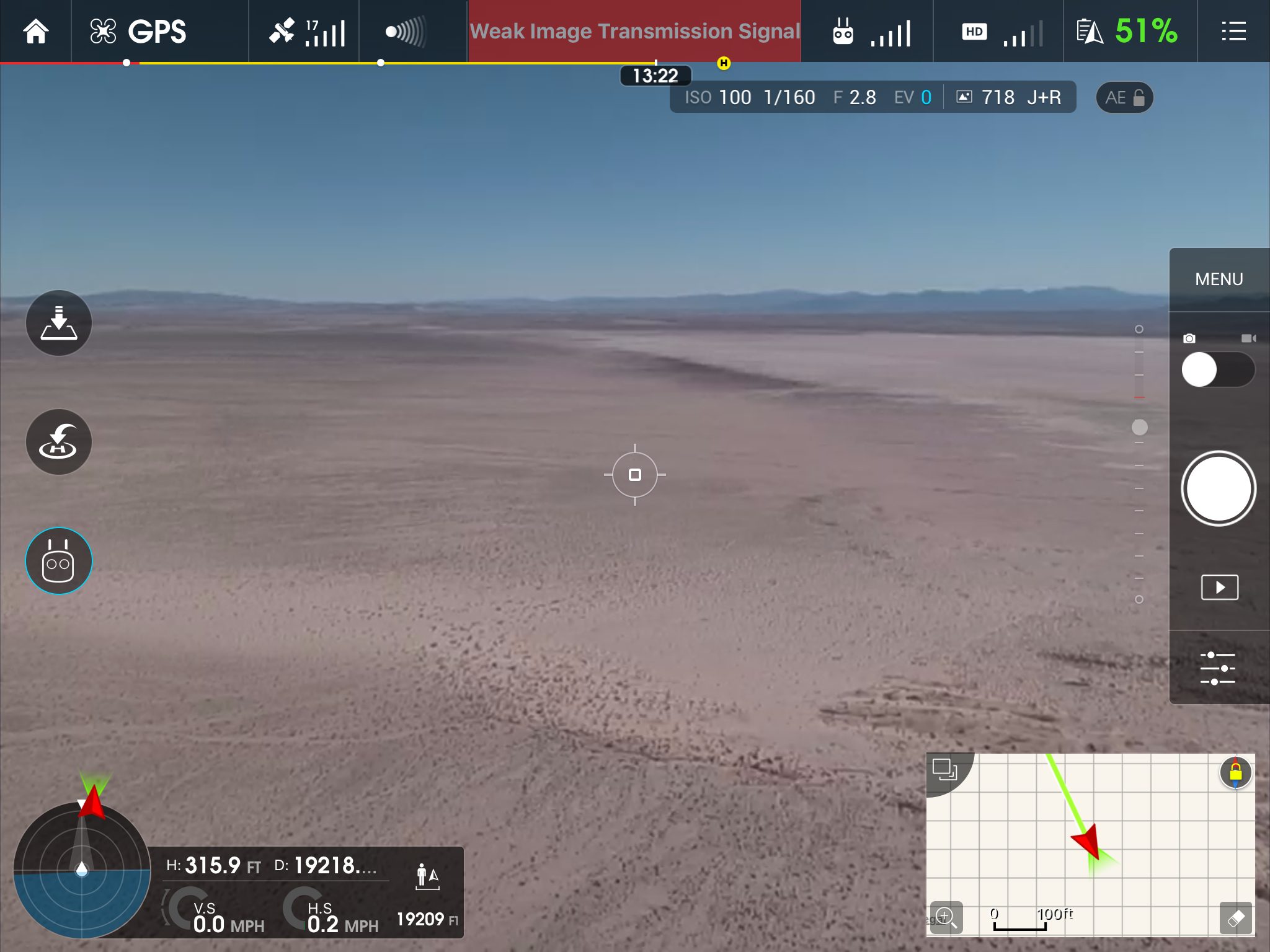

    I flew out 20,100 feet today in the wind. At my turnaround I had 3 bars left for video and rc signal had all bars.

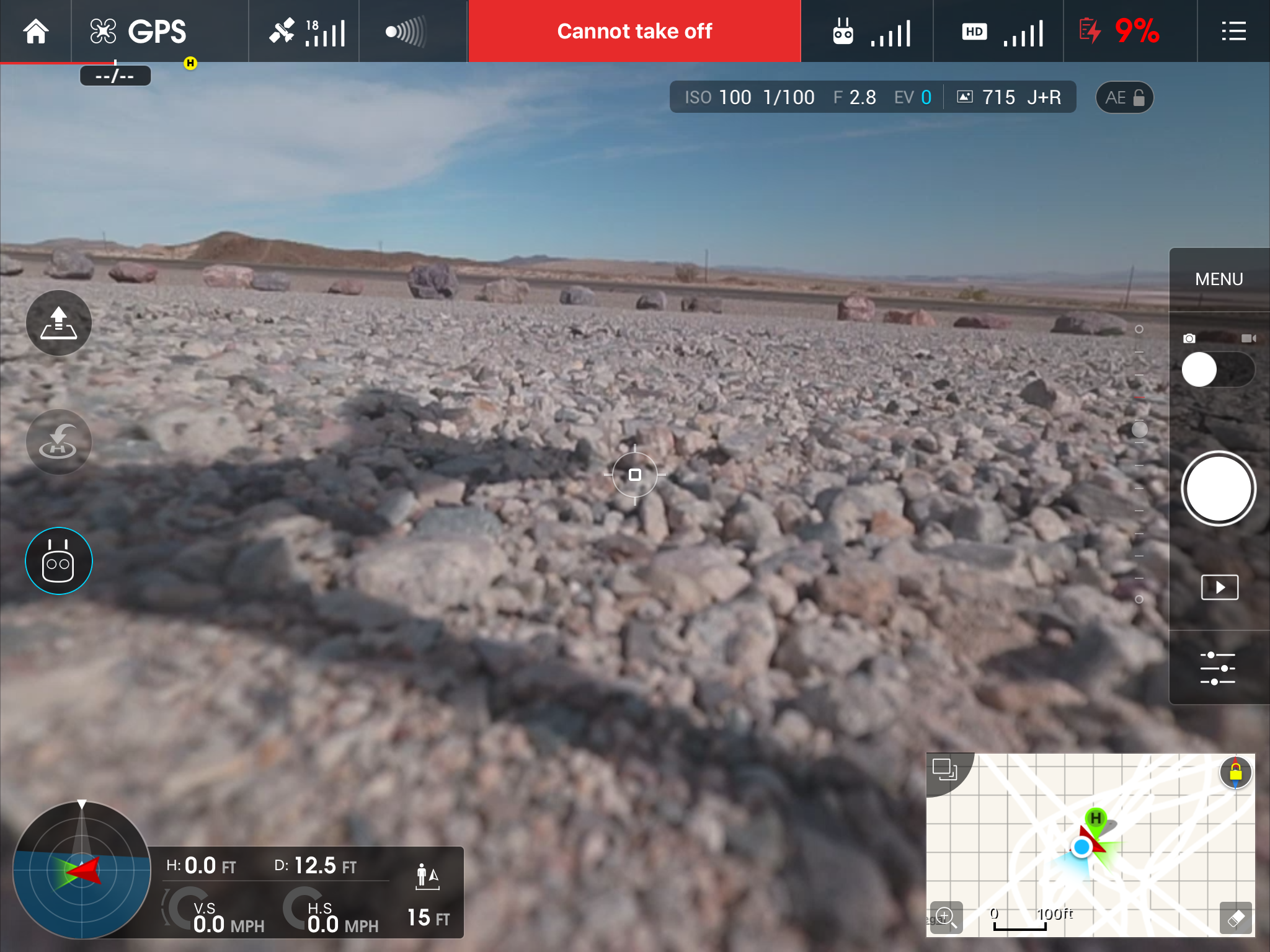

    At 19,200 feet I still had 4 and 5 bars. I tried to screenshot it, but I'm using an Ipad Air 2 and had to rest the RC on my knee to screenshot. When I lowered the RC I would lose the 4th bar for video. However, I did lose the 4th bar completely about another 600 feet away. At no time during this flight did I lose video, nor did it flicker. My goal was to reach 20,000 feet. I knew when I hit about 17,500 that I wasn't going to make it all the way back to my start point. The wind was causing me to burn up battery power. On the way back I was able to fly it within 3800 feet of my position. When the battery level reached critical I flew for about another minute or so and landed it near some easily identifiable terrain. I walked out got my P4 and came back. When I got back I noticed that I flew for 24 minutes and I had 9% battery left. If I would of flown it for that last 9% I might of made it back and I would of been pushing the "approx. 28 min" flight time. In the picture below it says 25min.

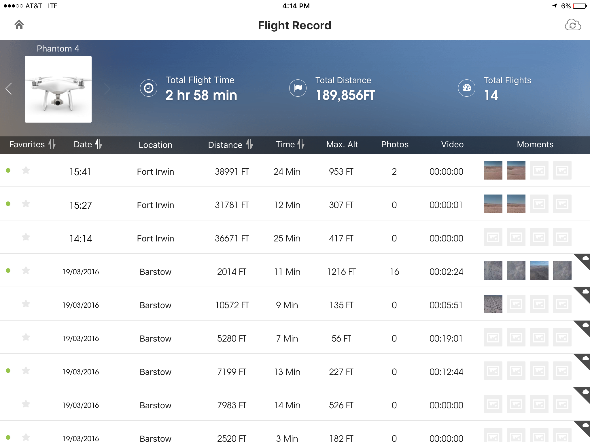

    Also, I did another battery test with a different battery and I had the same flight time. 24mins with approx. 10% left. It's the latest flight in the pic above.

    That is weird. I went 4 miles (21,219ft) out and 4 miles back in 17:01 with my bone stock v1 P3A, landed with 10% battery. Pushed out against a ~12mph headwind and rode it back the whole way home. Full throttle out full throttle back. Zero signal loss from either the RC or Video.
    If the P3 = P4 in battery and range you should have been able to make it back with the P4 and it should not have taken 24 minutes for you to go 20,108ft and back.
