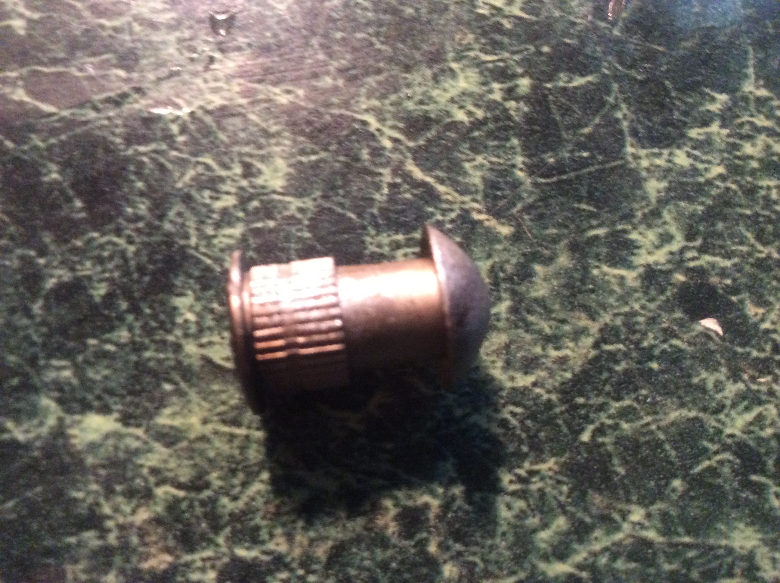

    Here ya go Monte . Had a broke one and melted the plastic off .

    Thanks Dirk. I wonder why it doesn't feel gritty if I force it to turn.

    No problem and don't know . It looked like it was pushed though and then braded . Not sure but you got me wondering
    so I put the fire to one :)

    There ya go... knurling as I suspected. At one time I was a mechanic at a large injection molding shop. Those pieces are molded in when the part is made. You set the hub into the mold and it forms around it. Once it breaks free of the surrounding plastic, the hole it is in is smoothed out so the knurling has nothing to grip.
