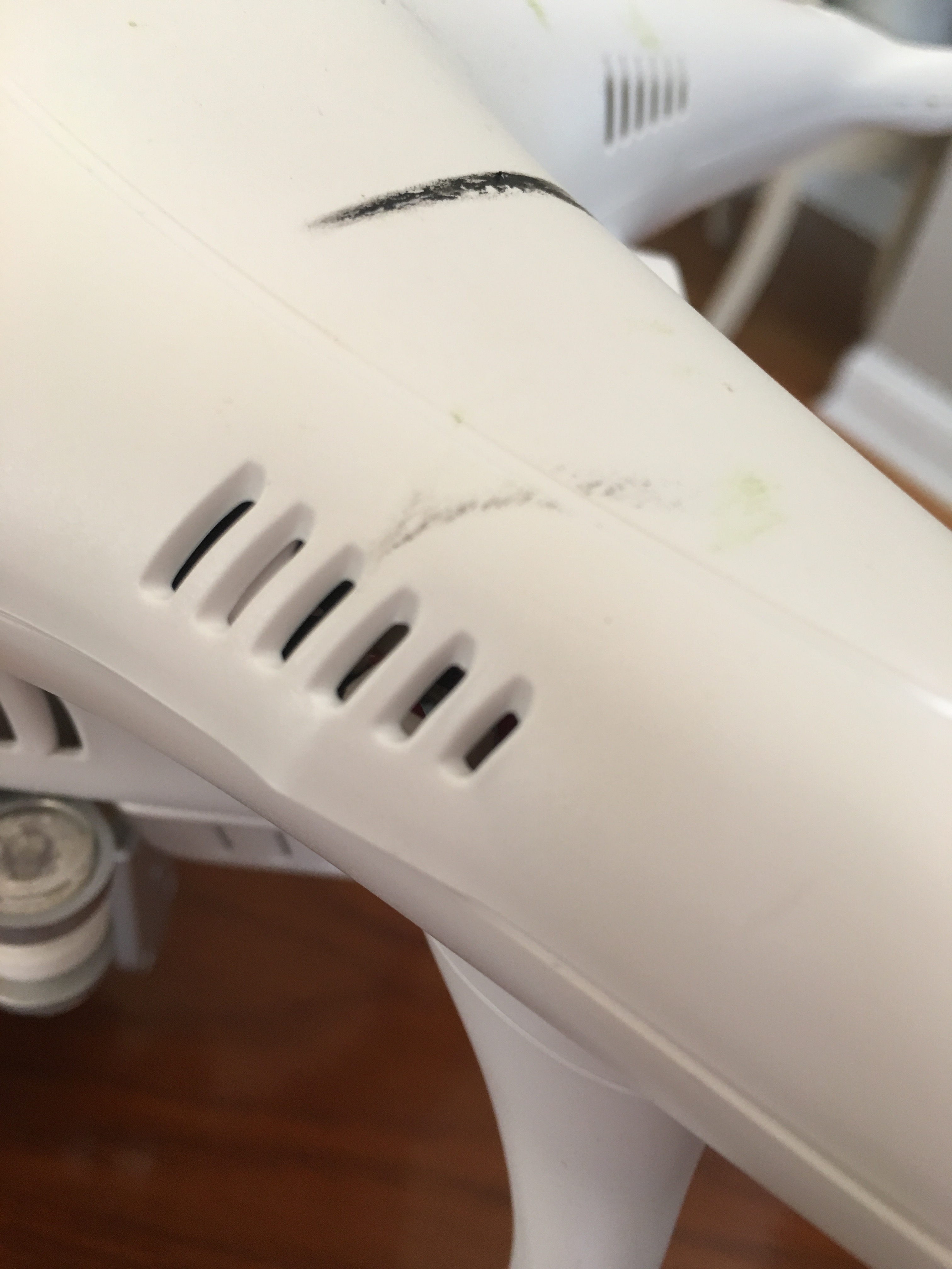

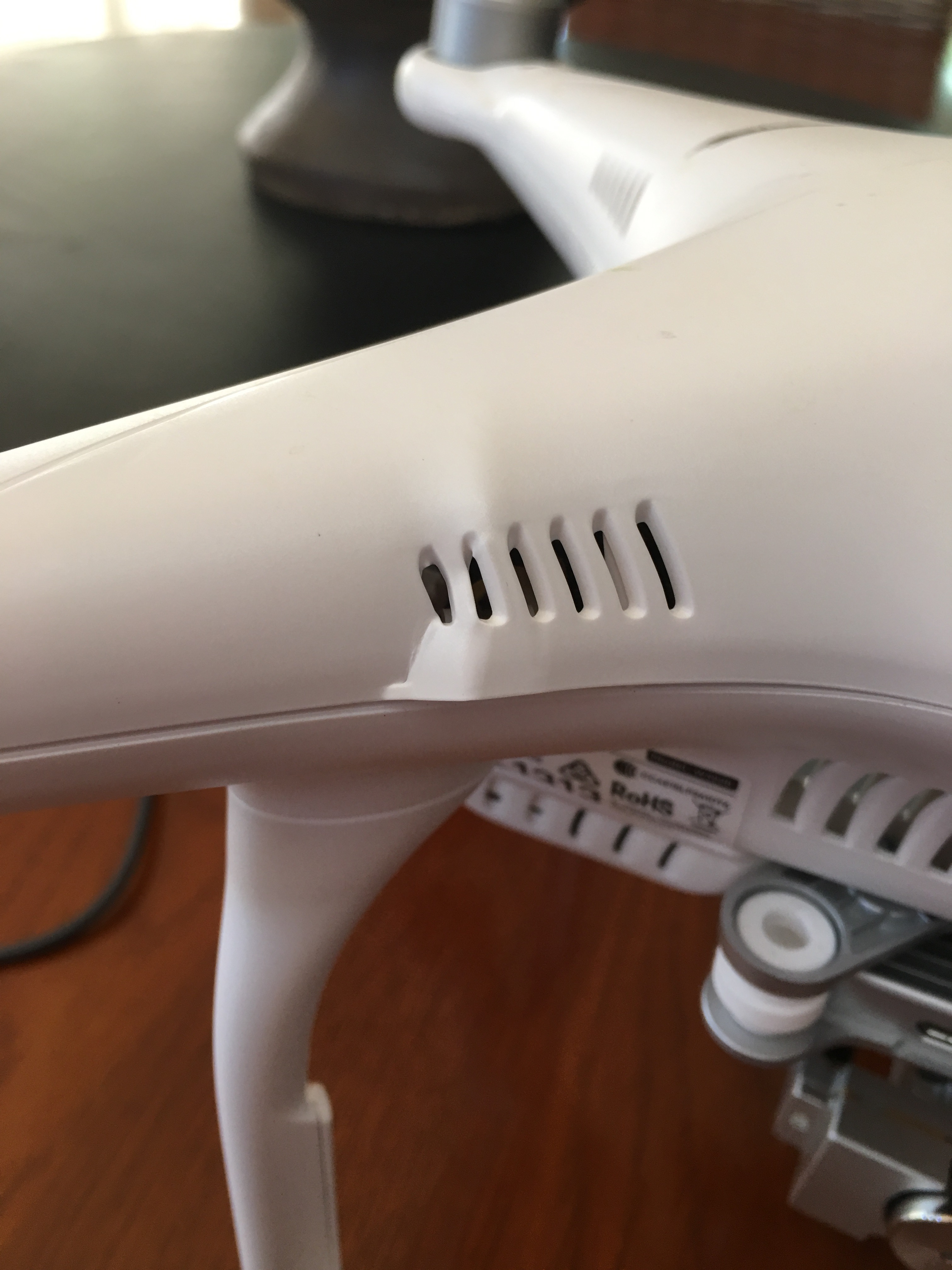

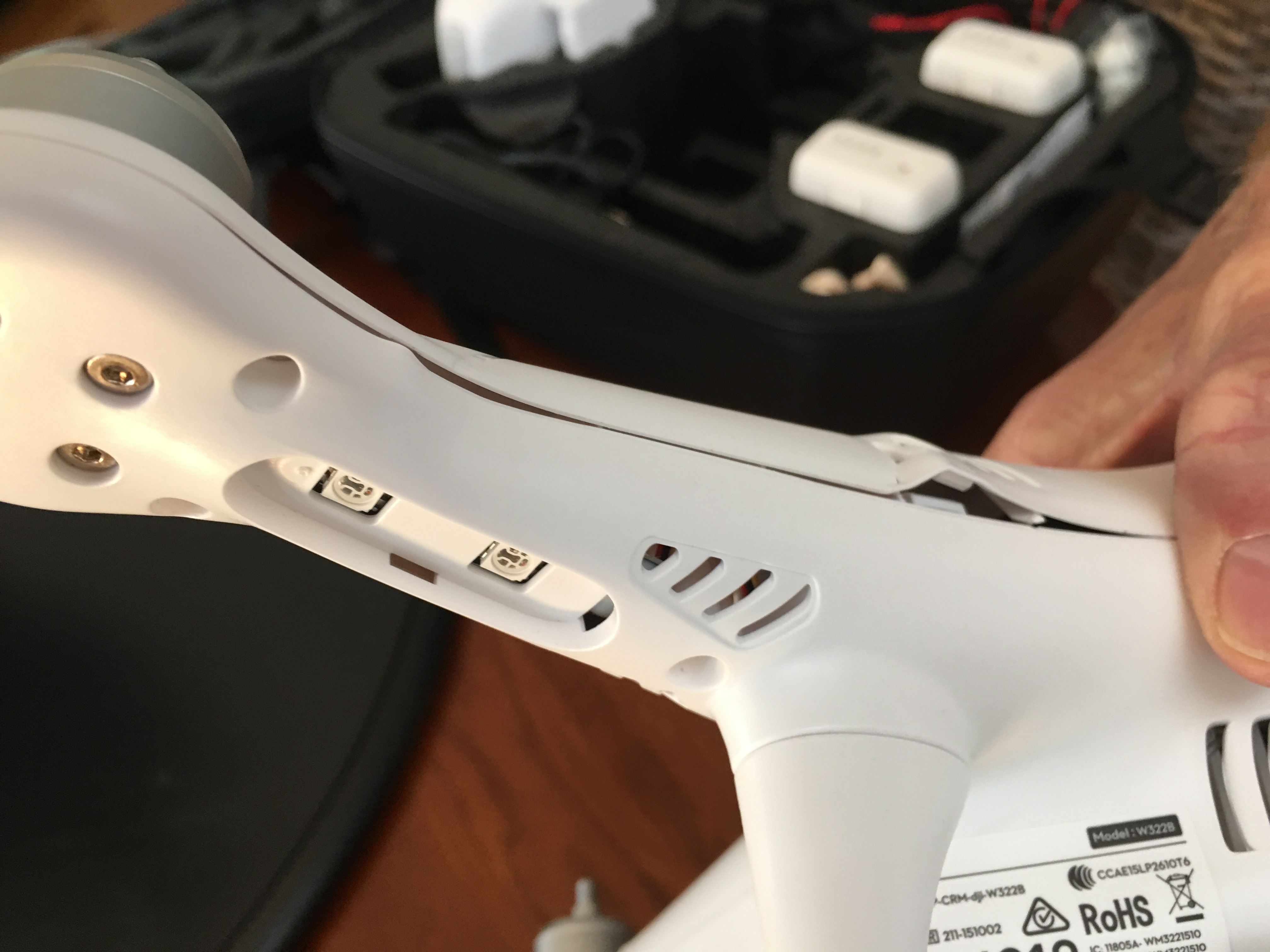

    One prop was gone and one broke, Battery was knocked lose but still in[​IMG] [​IMG] [​IMG]
  18. Wolfiesden
    Jan 12, 2016
    1,277
    436
    Milwaukee, WI, Ft Walton Beach, FL
    Well, there is your clue.
    I would bet one prop came off during flight due to improper tightening. If it was on the bird on takeoff, I can't imagine how it was not on it when it crashed other than it was lost during flight.
